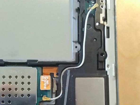

  5. Samsung Galaxy Note 10.1 2014 Screen Replacement, Loudspeaker Modules: crwdns2935265:05crwdnd2935265:01crwdnd2935265:02crwdne2935265:0 Samsung Galaxy Note 10.1 2014 Screen Replacement, Loudspeaker Modules: crwdns2935265:05crwdnd2935265:02crwdnd2935265:02crwdne2935265:0
    • Remove the three 3mm screws on the top right side of the device with the Phillips PH000 screw head.
    • Remove the one 3mm screw on the top left side of the device with the same method.

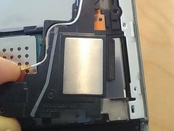

  6. Samsung Galaxy Note 10.1 2014 Screen Replacement, loudspeaker  - remove right speaker: crwdns2935265:06crwdnd2935265:01crwdnd2935265:03crwdne2935265:0 Samsung Galaxy Note 10.1 2014 Screen Replacement, loudspeaker  - remove right speaker: crwdns2935265:06crwdnd2935265:02crwdnd2935265:03crwdne2935265:0 Samsung Galaxy Note 10.1 2014 Screen Replacement, loudspeaker  - remove right speaker: crwdns2935265:06crwdnd2935265:03crwdnd2935265:03crwdne2935265:0

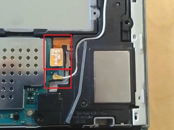

    • Remove the gray rubber piece.
    • Use a spudger or fingernail to disconnect the blue antenna cable from the motherboard.
    • Remove the right speaker unit.

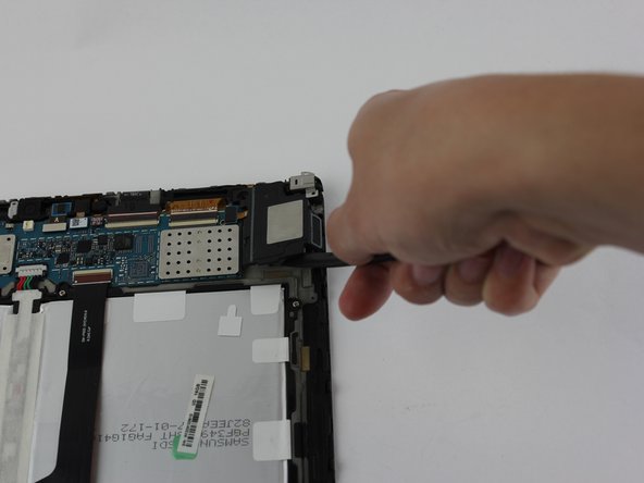

  7. Samsung Galaxy Note 10.1 2014 Screen Replacement: crwdns2935265:07crwdnd2935265:01crwdnd2935265:03crwdne2935265:0 Samsung Galaxy Note 10.1 2014 Screen Replacement: crwdns2935265:07crwdnd2935265:02crwdnd2935265:03crwdne2935265:0 Samsung Galaxy Note 10.1 2014 Screen Replacement: crwdns2935265:07crwdnd2935265:03crwdnd2935265:03crwdne2935265:0
    • Remove the loudspeaker modules located on the parts where the screws were removed by using the black nylon spudger.
    • They are the black pieces at the top left and right corners of the device that have metal squares on them in the middle.

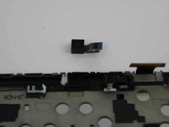

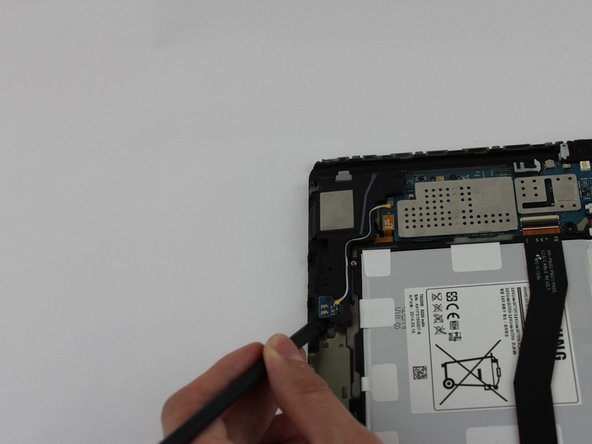

  8. Samsung Galaxy Note 10.1 2014 Screen Replacement, Rear Camera: crwdns2935265:08crwdnd2935265:01crwdnd2935265:02crwdne2935265:0 Samsung Galaxy Note 10.1 2014 Screen Replacement, Rear Camera: crwdns2935265:08crwdnd2935265:02crwdnd2935265:02crwdne2935265:0

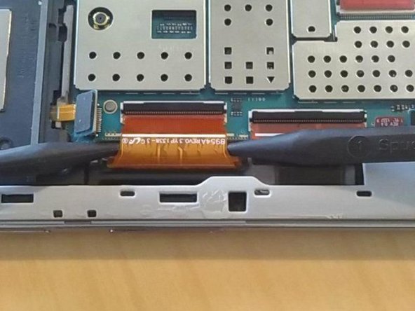

    • Disconnect the camera piece from the motherboard.
    • The camera piece is shaped like an "L".
  9. Samsung Galaxy Note 10.1 2014 Screen Replacement, Motherboard: crwdns2935265:09crwdnd2935265:01crwdnd2935265:03crwdne2935265:0 Samsung Galaxy Note 10.1 2014 Screen Replacement, Motherboard: crwdns2935265:09crwdnd2935265:02crwdnd2935265:03crwdne2935265:0 Samsung Galaxy Note 10.1 2014 Screen Replacement, Motherboard: crwdns2935265:09crwdnd2935265:03crwdnd2935265:03crwdne2935265:0
    • Disconnect all cables on the motherboard.
    • See our connector guide for help safely disconnecting various types of connectors.

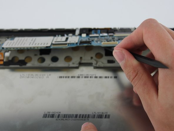

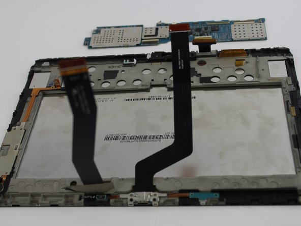

  10. Samsung Galaxy Note 10.1 2014 Screen Replacement: crwdns2935265:010crwdnd2935265:01crwdnd2935265:03crwdne2935265:0 Samsung Galaxy Note 10.1 2014 Screen Replacement: crwdns2935265:010crwdnd2935265:02crwdnd2935265:03crwdne2935265:0 Samsung Galaxy Note 10.1 2014 Screen Replacement: crwdns2935265:010crwdnd2935265:03crwdnd2935265:03crwdne2935265:0
    • Use the black nylon spudger to gently lift the motherboard away from the frame.
    • Remove the motherboard.
