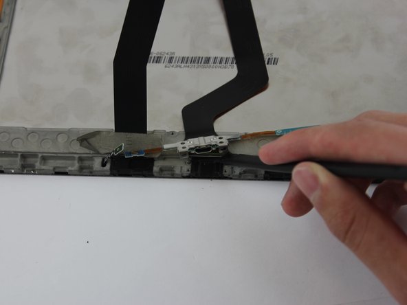

  5. Samsung Galaxy Note 10.1 2014 Charging Port Replacement, Charging Port: crwdns2935265:05crwdnd2935265:01crwdnd2935265:01crwdne2935265:0
    • Using the PH000 screwdriver, remove the two black 3mm screws at the bottom of the device.
  6. Samsung Galaxy Note 10.1 2014 Charging Port Replacement: crwdns2935265:06crwdnd2935265:01crwdnd2935265:02crwdne2935265:0 Samsung Galaxy Note 10.1 2014 Charging Port Replacement: crwdns2935265:06crwdnd2935265:02crwdnd2935265:02crwdne2935265:0
    • After disconnecting the two blue electronic connectors, unhinge the metal part of the charging port with the black nylon spudger.
    • Make sure to also disconnect the other end of the ribbon as well by pushing back the thin black metal bar.

Great guide. It helped me find the right component to order and gave me confidence to fix it myself. Actually the steps can be shortened. The battery does not need to be removed. So you need to do step 1 (remove the cover), first part of step 2 (remove the flat cable of the charge plug), step 5 and 6. Step 7 should be to replace the old part with the new part. And then of course the reversal of reconnecting via steps 6, 5, 2 and 1.

This guide enabled me to replace a bad charging port.
Note - the replacement microUSB port didn’t have the little chrome frame around the port - so I had to carefully scavenge the frame from the old one just to give the new port a little more support when plugging in a cable.
I’m going to use a magnetic charging adapter to reduce the wear and tear on the port, but this one saved the day.
