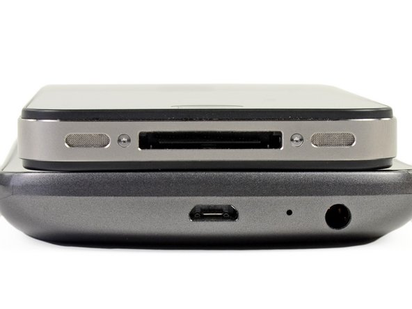

    • How does the Galaxy Nexus stack up to the iPhone 4S?
    • In terms of size, the Galaxy Nexus is big enough (5.33 x 2.67 x 0.35 inches) to devour the 4S, so hopefully you have large pockets.
    • Though it is larger than the iPhone 4S, this Galaxy Nexus is 5 grams lighter (135 compared to 140).

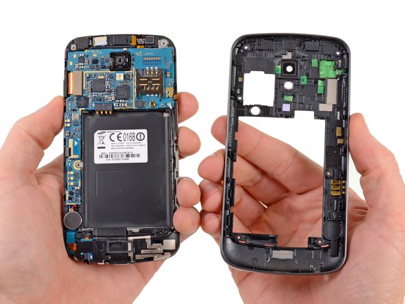

    • Insert finger here, wiggle finger thusly, and pop goes the panel!
    • OK, we'll come clean; the phone shipped with the battery removed. We first had to install the battery and back cover, and then we did some prying. This assuredly confirms one thing: the battery is user-serviceable.

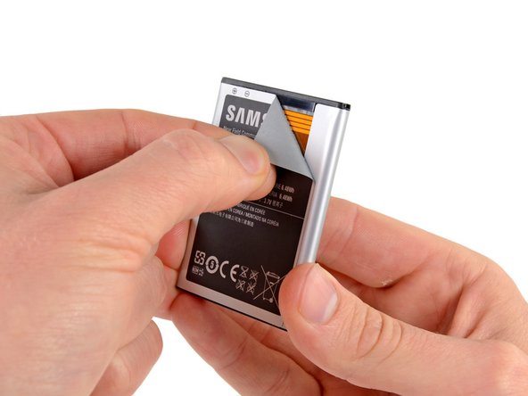

    • Not only does the 3.7 V, 1750 mAh battery power the phone, but the user manual states that it also doubles as the NFC antenna.
    • O RLY? We had to see this one for ourselves.
    • Lo and behold, there's a sweet antenna hiding underneath the battery's shiny wrapper. So if you ever want to buy a replacement battery (and keep NFC functional), ensure that the battery has the antenna.
    • Our battery says "Near Field Communication" on it, so that might be a good indicator if it will function as an NFC antenna.

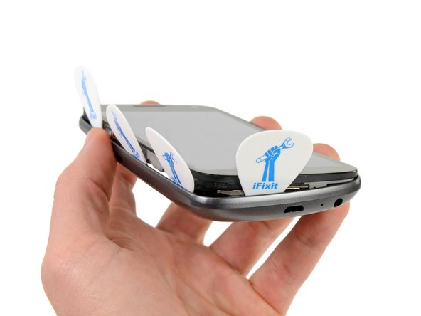

    • Whipping out our handy 54 Bit Driver Kit, we reach for a Phillips #0 bit and get to work opening the phone.
    • We wrenched our plastic opening tool till it was blue in the face and went through more guitar picks than Jimmy Page, but we managed to take off the back case. No device is too tough for the dexterous hands of the iFixit crew!

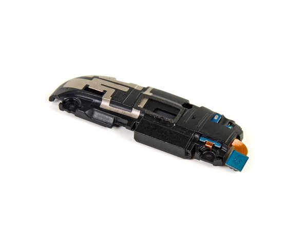

    • One little screw shackles the speaker and headphone jack assembly to the motherboard.
    • Goodbye, little screw; hello, speaker and headphone jack assembly.
    • With access to Google Music and high definition movies, there's no doubt that Galaxy Nexus owners will want their phone to make some beautiful noise. Unfortunately, our disassembled phone didn't make a single chirp.

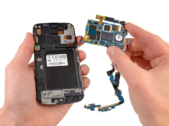

    • A few connectors here, some screws there, and a wee bit of glue everywhere…nothing stands a chance against our spudger! The motherboard dislodges from its home with moderate force, but nothing too extreme.

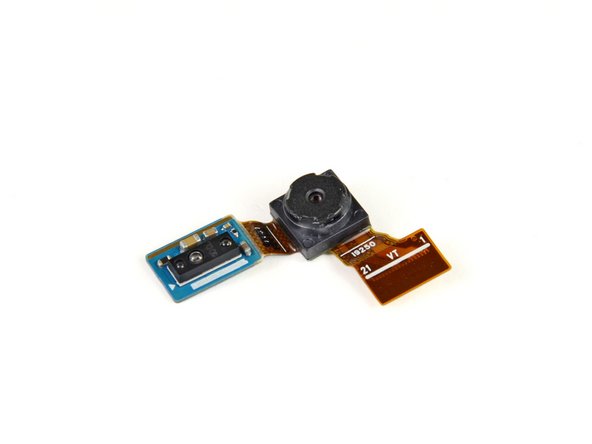

    • A flick of the spudger and out come the front- and rear-facing cameras.
    • The 5 megapixel rear-facing camera is optimized for low light conditions and has a handy continuous auto-focus feature that'll surely help keep those quick moments clear. If you prefer moving pictures, this camera can capture full HD 1080p "talkies."
    • The front-facing camera allows for video chat and will take pictures at 1.3 MP or videos at 720p.

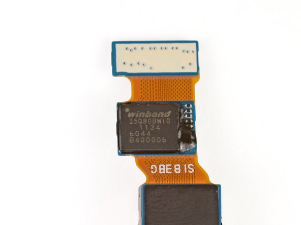

    • The rear-facing camera has a Winbond 8 Mb Serial Flash Memory unit in line to help it buffer all the data it collects.

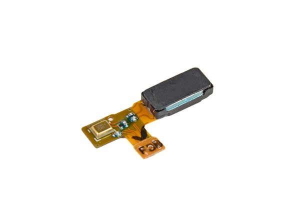

    • The ear speaker pops off the motherboard without much effort.
    • The ability to replace individual components inside the Galaxy Nexus impresses us, since this will make repair less costly.

    • The primary internals of the Galaxy Nexus are held on two L-shaped boards. The small board on the left holds the vibrator motor and several connections. The large board on the right is the motherboard, which houses the volume buttons, SIM slot and the following chips:
    • Texas Instruments TWL6040 8-Channel High Quality Low-Power Audio Codec
    • Texas Instruments TWL6030 Fully Integrated Power Management with Switch Mode Charger
    • Invensense MPU-3050 Motion Processing Unit
    • Intel XG626 Baseband Modem
    • Bosch BMP180 MEMS Pressure Sensor

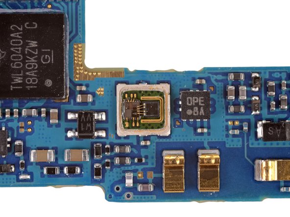

    • The chip labeled as 274 U141 031 hides the Bosch BMP180 MEMS Pressure Sensor, which should be responsible for the "Barometer" feature inside the Nexus.
    • The Bosch BMP180 is identified by its markings CMD 173 as noted by our friends at Chipworks.
    • Check out the wire bonds on the third image. This is a very, very small chip.
    • Just how small is it? Well, here's how a U.S. dime looks like next to the chip (indicated by red arrow)
