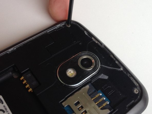

    • Remove the back cover, battery and sim-card, I'm sure you've done this a couple of times before.
    • Remove the 6 (or 7, if your phone uses CDMA) screws that are holding the housing in place.

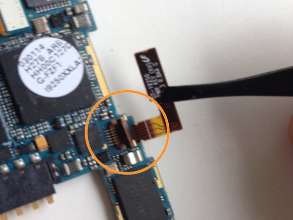

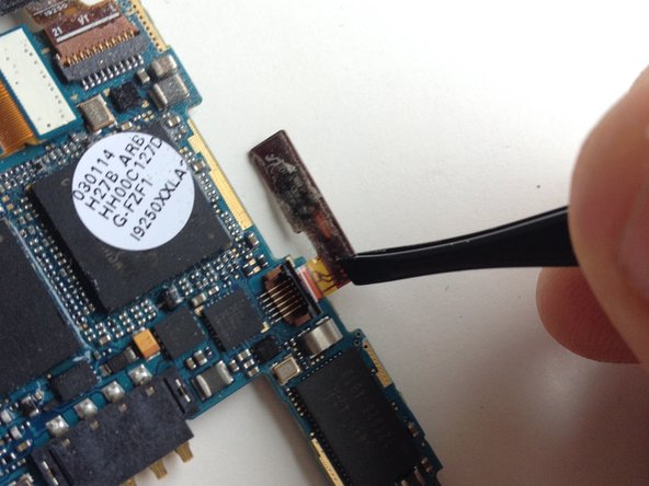

    • Use your opening tool to open the latch that holds the power button flex cable in place.
    • Make sure you open the black part of the latch, I tried prying at the brown part thinking that would open it, it didn't. No harm done though.
    • Use your tweezers to take the old flex cable out and out the new one in, this can probably be done by hand but it takes a bit of precision.
    • Don't forget to put that latch back down! (and sorry about the blurry picture)
