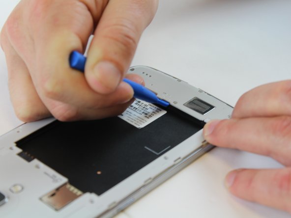

    • Before starting, ensure device is completely turned off.
    • On the back of phone, locate the slot on the top left corner.
    • Insert plastic opening tool or fingernail and pull up on the back plate.
    • With the corner released, slide your finger around the device between the back plate and the phone to release connectors.
  2. Samsung Galaxy Mega Speaker Assmebly Replacement: crwdns2935265:02crwdnd2935265:01crwdnd2935265:03crwdne2935265:0 Samsung Galaxy Mega Speaker Assmebly Replacement: crwdns2935265:02crwdnd2935265:02crwdnd2935265:03crwdne2935265:0 Samsung Galaxy Mega Speaker Assmebly Replacement: crwdns2935265:02crwdnd2935265:03crwdnd2935265:03crwdne2935265:0
    • Insert fingernail into the slot on bottom of battery and gently pull up.
    • Remove the battery.

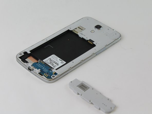

  3. Samsung Galaxy Mega Speaker Assmebly Replacement, Speaker Assembly: crwdns2935265:03crwdnd2935265:01crwdnd2935265:03crwdne2935265:0 Samsung Galaxy Mega Speaker Assmebly Replacement, Speaker Assembly: crwdns2935265:03crwdnd2935265:02crwdnd2935265:03crwdne2935265:0 Samsung Galaxy Mega Speaker Assmebly Replacement, Speaker Assembly: crwdns2935265:03crwdnd2935265:03crwdnd2935265:03crwdne2935265:0
    • Remove the 6 3.45 mm Phillips #000 screws from the bottom of the assembly surrounding the speaker.
    • Gently insert plastic opening tool through the inside groove of the speaker assembly.
    • Once the top part of the speaker assembly pops free. Gently lift up with your fingers to remove speaker.
