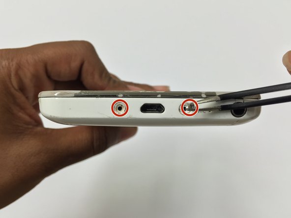

    • White caps cover screws on both sides of the charging port. Use the angled tweezers to remove them.
    • Use a blow dryer on low heat if necessary to loosen the adhesive.

    • Using a Phillips head screwdriver, unscrew the two 10 mm screws located on either side of the charging port.

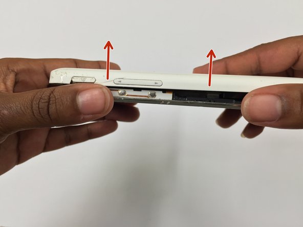

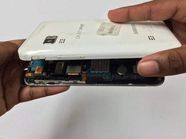

    • Using the opening pick, pry at the bottom and work around each edge of the device until the front cover and back cover housing is separated.
    • You will hear a popping sound to indicate the separation.

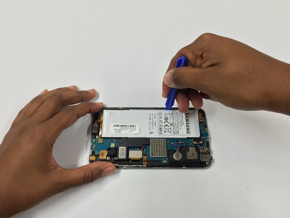

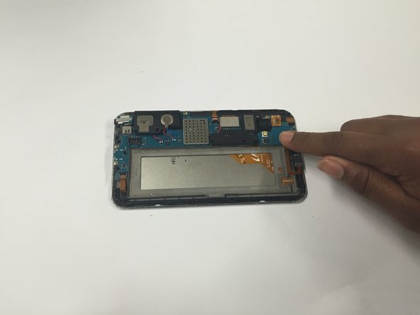

    • Using the plastic opening tool, apply an upward force to detach the battery and the tab attached to it.

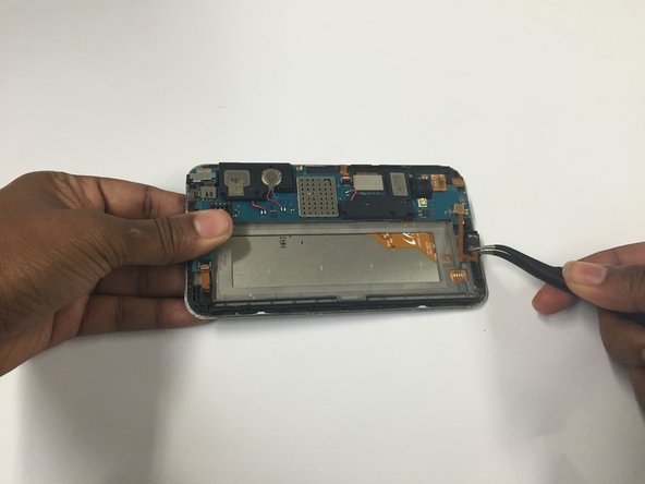

    • Using the plastic opening tool, apply an upward force to detach the speaker earpiece.
    • Use the tweezers to attach the new earpiece speaker in place of the original.
    • Use a blow dryer, on low heat settings, to loosen the adhesive on the speaker earpiece.
