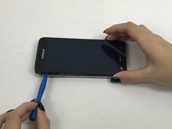

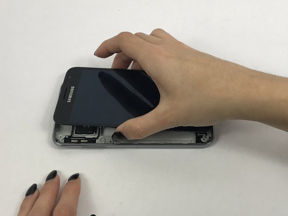

    • Use a small suction cup to pull the screen up. Then slip a small plastic opening tool under the screen to pry it upwards.
    • If this is the first time the screen is being removed then there will be adhesive around the edges of the screen. It may be difficult to remove the screen because of this adhesive seal and it is going to take a few tries and some force to pry the entire screen off.

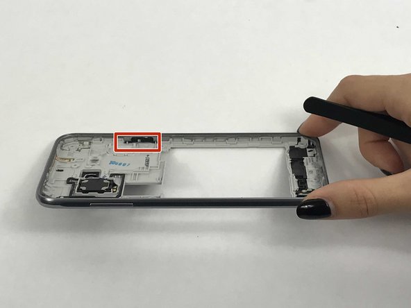

    • After opening the phone, locate the power button on the back frame of the phone.
  5. Samsung Galaxy J3V Power Button Replacement: crwdns2935265:05crwdnd2935265:01crwdnd2935265:03crwdne2935265:0 Samsung Galaxy J3V Power Button Replacement: crwdns2935265:05crwdnd2935265:02crwdnd2935265:03crwdne2935265:0 Samsung Galaxy J3V Power Button Replacement: crwdns2935265:05crwdnd2935265:03crwdnd2935265:03crwdne2935265:0

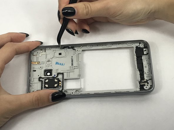

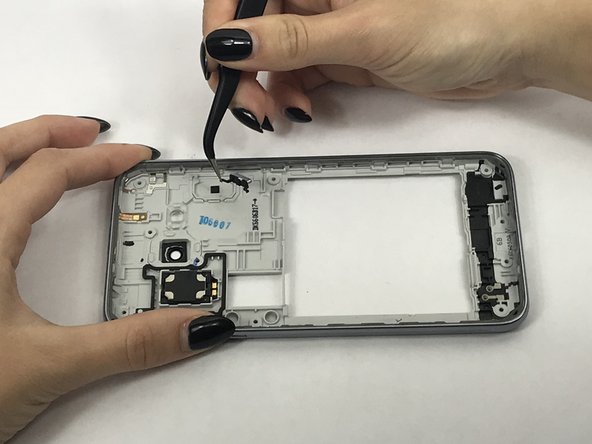

    • Using tweezers, remove the power button's rubber tabs from the clips holding them.
    • Gently remove the entire button
