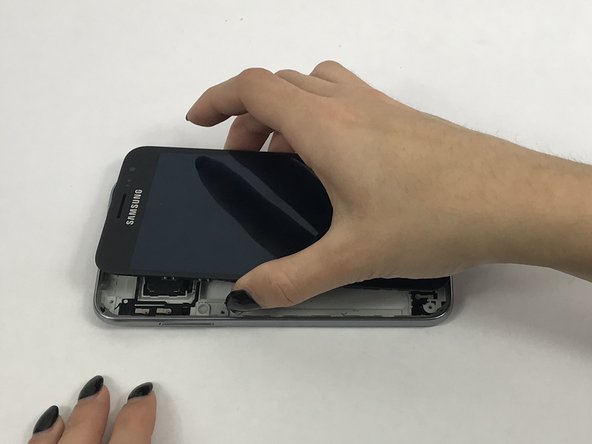

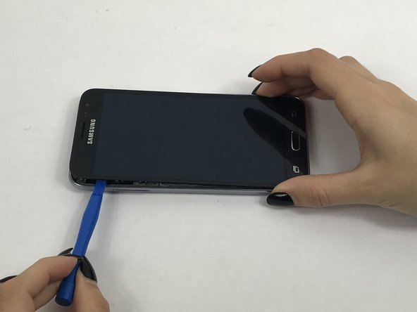

    • Use a small suction cup to pull the screen up. Then slip a small plastic opening tool under the screen to pry it upwards.
    • If this is the first time the screen is being removed then there will be adhesive around the edges of the screen. It may be difficult to remove the screen because of this adhesive seal and it is going to take a few tries and some force to pry the entire screen off.

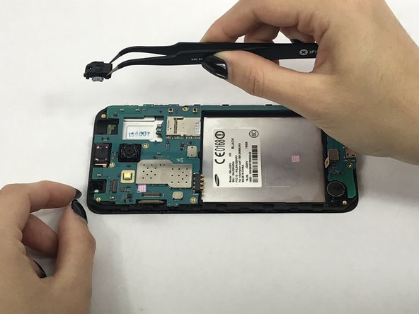

  4. Samsung Galaxy J3V Headphone Jack Replacement: crwdns2935265:04crwdnd2935265:01crwdnd2935265:03crwdne2935265:0 Samsung Galaxy J3V Headphone Jack Replacement: crwdns2935265:04crwdnd2935265:02crwdnd2935265:03crwdne2935265:0 Samsung Galaxy J3V Headphone Jack Replacement: crwdns2935265:04crwdnd2935265:03crwdnd2935265:03crwdne2935265:0
    • Remove connector tab with spudger then carefully remove headphone jack with tweezers.
