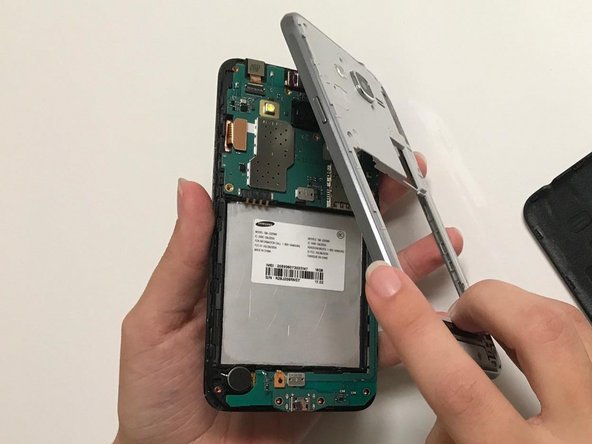

    • Use the flat side of the metal spudger to remove the middle frame bezel.
    • Do not use a wrenching motion while performing this step. The screen may crack.

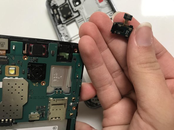

    • Detach the headphone jack from the motherboard plug-in.
    • Replace the headphone jack.
To reassemble your device, follow these instructions in reverse.
