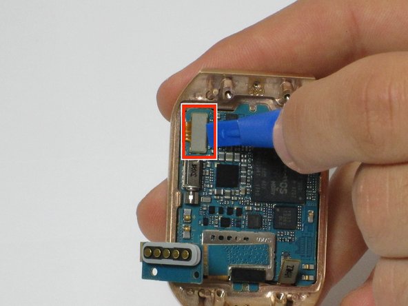

      • Gently pry back the metal flap on top of the connector.
      • Locate the two 2.0 mm black screws and unscrew using a Phillips PH00 bit. The connector will detach from the device.
    1. Samsung Galaxy Gear Display Assembly Replacement, Motherboard: crwdns2935265:04crwdnd2935265:01crwdnd2935265:02crwdne2935265:0 Samsung Galaxy Gear Display Assembly Replacement, Motherboard: crwdns2935265:04crwdnd2935265:02crwdnd2935265:02crwdne2935265:0
      • On the display, use a plastic opening tool to lift up the two ribbon cables the motherboard.

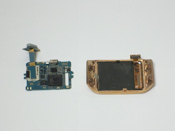

    2. Samsung Galaxy Gear Display Assembly Replacement: crwdns2935265:05crwdnd2935265:01crwdnd2935265:01crwdne2935265:0
      • The motherboard is attached to the display using an adhesive
      • Using a heat gun, heat up the display for 4 to 5 minutes, making sure the move the heat gun around to distribute the heat around the display. This heats up the adhesive making the motherboard easier to remove
    3. Samsung Galaxy Gear Display Assembly Replacement: crwdns2935265:06crwdnd2935265:01crwdnd2935265:02crwdne2935265:0 Samsung Galaxy Gear Display Assembly Replacement: crwdns2935265:06crwdnd2935265:02crwdnd2935265:02crwdne2935265:0
      • Using a plastic opening tool, carefully insert the opening tool in between the bezel and the motherboard and slide it the entire length of the logic board.
      • Slowly pry up the motherboard from the display.
    1. Samsung Galaxy Gear Display Assembly Replacement, Display Assembly: crwdns2935265:07crwdnd2935265:01crwdnd2935265:01crwdne2935265:0
      • The display assembly is now separated and can be replaced
