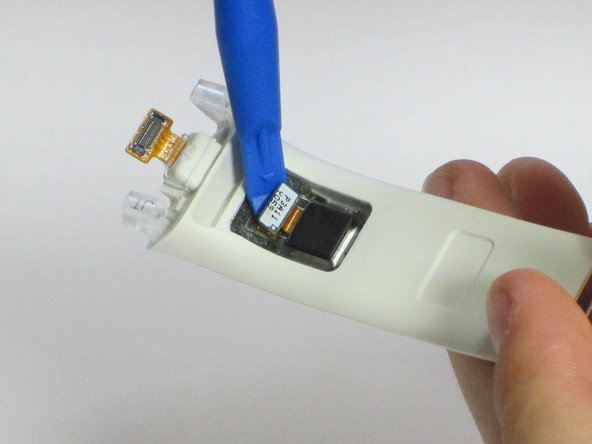

    1. Samsung Galaxy Gear Camera Replacement, Camera: crwdns2935265:03crwdnd2935265:01crwdnd2935265:02crwdne2935265:0 Samsung Galaxy Gear Camera Replacement, Camera: crwdns2935265:03crwdnd2935265:02crwdnd2935265:02crwdne2935265:0
      • Use the plastic opening tool to pry the camera backdoor.
      • Use the plastic opening tool to pry the tab and pull the camera.
