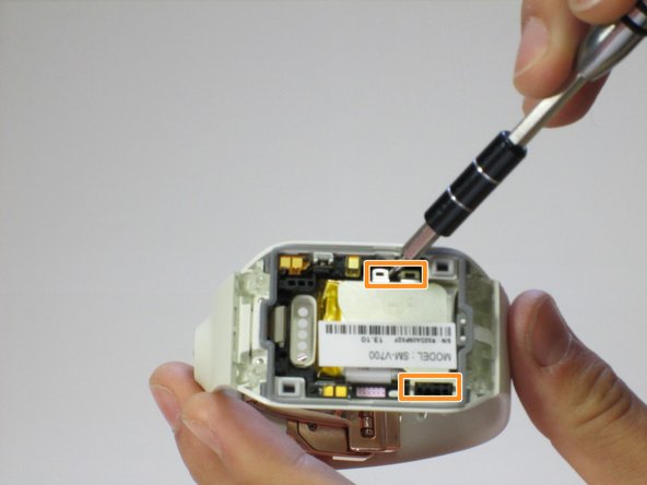

  3. Samsung Galaxy Gear Battery Replacement: crwdns2935265:03crwdnd2935265:01crwdnd2935265:02crwdne2935265:0 Samsung Galaxy Gear Battery Replacement: crwdns2935265:03crwdnd2935265:02crwdnd2935265:02crwdne2935265:0
    • Gently pry back the metal flap on top of the connector.
    • Locate the two 2.0 mm black screws and unscrew using a Phillips PH00 bit. The connector will detach from the device.

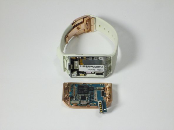

  4. Samsung Galaxy Gear Battery Replacement, Battery: crwdns2935265:04crwdnd2935265:01crwdnd2935265:02crwdne2935265:0 Samsung Galaxy Gear Battery Replacement, Battery: crwdns2935265:04crwdnd2935265:02crwdnd2935265:02crwdne2935265:0
    • After separating the LCD/motherboard from the actual watch itself, the watch should be in two separate pieces.
    • You will only need the watch/strap component so you can set aside the LCD/motherboard component.

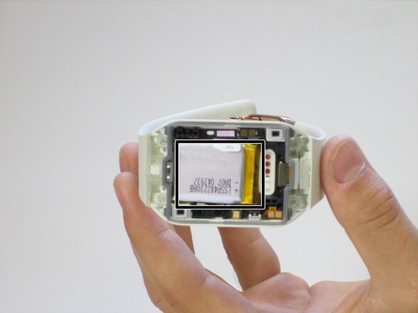

  5. Samsung Galaxy Gear Battery Replacement: crwdns2935265:05crwdnd2935265:01crwdnd2935265:03crwdne2935265:0 Samsung Galaxy Gear Battery Replacement: crwdns2935265:05crwdnd2935265:02crwdnd2935265:03crwdne2935265:0 Samsung Galaxy Gear Battery Replacement: crwdns2935265:05crwdnd2935265:03crwdnd2935265:03crwdne2935265:0
    • Look for the metal bracket that covers and secures the battery in place.
    • Loosen the bracket by prying underneath the metal plating with the plastic opening tool. Remove the bracket and set it to the side.
    • The battery should now be exposed.

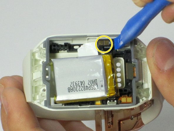

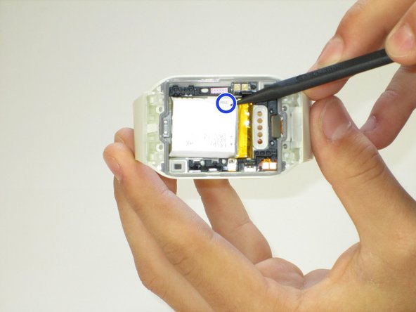

  6. Samsung Galaxy Gear Battery Replacement: crwdns2935265:06crwdnd2935265:01crwdnd2935265:03crwdne2935265:0 Samsung Galaxy Gear Battery Replacement: crwdns2935265:06crwdnd2935265:02crwdnd2935265:03crwdne2935265:0 Samsung Galaxy Gear Battery Replacement: crwdns2935265:06crwdnd2935265:03crwdnd2935265:03crwdne2935265:0
    • Notice the leads attached to the base of the watch. You will need to remove this before you pull the battery out.
    • Using the plastic opening tool, pry underneath the leads and disconnect it from the back of the watch.
    • Slowly tug on the "PULL" tag and remove the battery from the watch.
