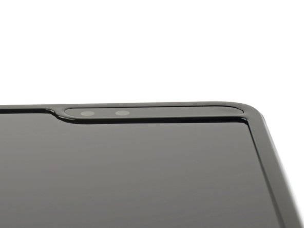

    • Samsung has shored up many of the leaky spots that previously plagued this phone.
    • Perhaps the most prominent entry point for display-killing debris was at either end of the fold, where a break in the hard plastic bezel left a big gap.
    • We're happy to see that Samsung added a small protective cover to close the gap and prevent our tools debris from sneaking in behind the screen.
    • When closed, the screen is protected—but the spine is still flanked by gaps that our opening picks hop right into. These gaps are less likely to cause immediate screen damage, but will definitely attract dirt.
    • It seems Samsung is trying to cover the most immediately threatening ingress points, but it's extremely challenging to completely seal off a phone with this many moving parts. It'll be interesting to see how future folding designs overcome this.

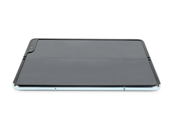

    • Did we mention it's thick? Folding phones are cool and all, but good luck fitting this thing into your skinny jeans.
    • The hinge area packs the bulk of the, uh, bulk—partly because the screen doesn't fold completely flat. It closes more like a binder than a book, making contact only at the outer edge.
    • Putting the fold on the inside rather than around the outside makes for a tighter radius and a whole different set of camera placement problems than, say, Huawei's approach with the upcoming Mate X.
    • In its unfolded form, the main screen sports a slightly raised bezel, meaning there's a noticeable lip around the edges that you can feel under your fingers. This likely protects the display when it's folded or resting face-down on a table.
    • Word on the street is that scandalous screen protector now extends all the way under this raised bezel, away from prying hands. Will that protect it from us, though? Probably not.
    • The phone ships un-folded—but fold it even once, and that crease becomes pretty easy to spot if you're looking.

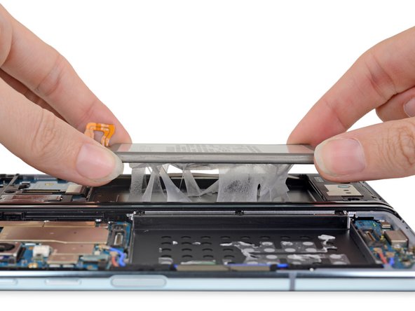

  8. Samsung Galaxy Fold Teardown: crwdns2935265:08crwdnd2935265:01crwdnd2935265:03crwdne2935265:0 Samsung Galaxy Fold Teardown: crwdns2935265:08crwdnd2935265:02crwdnd2935265:03crwdne2935265:0 Samsung Galaxy Fold Teardown: crwdns2935265:08crwdnd2935265:03crwdnd2935265:03crwdne2935265:0
    • One battery, two batteries, way-too-much-glue batteries. In typical Samsung fashion, they come out with isopropyl alcohol and a lot of swearing.
    • If dimensions are your thing, the taller, front-facing battery is 42.2 x 76.8 x 3.8 mm, and the battery in the rear-facing section with all the cameras measures 42.6 x 64.3 x 4.8 mm.
    • But really, here's the measurement that matters: 8.22 and 8.65 Wh, respectively, or 2135 mAh and 2245 mAh.
    • Those are each less potent than the 11+ Wh power packs in any of the S10 phones, but in tandem they provide 16.87 Wh of power.
    • That's less than most tablets, including the 19.32 Wh cell in the newest iPad Mini—but since this is technically a smartphone, that's ... impressive?

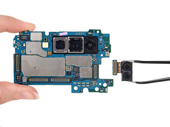

  9. Samsung Galaxy Fold Teardown: crwdns2935265:09crwdnd2935265:01crwdnd2935265:03crwdne2935265:0 Samsung Galaxy Fold Teardown: crwdns2935265:09crwdnd2935265:02crwdnd2935265:03crwdne2935265:0 Samsung Galaxy Fold Teardown: crwdns2935265:09crwdnd2935265:03crwdnd2935265:03crwdne2935265:0
    • Beneath the main board, a sign. Some friendly manufacturing QA professional has inscribed the copper heat sink with the letters TD—which, come on, can only mean Tear Down. Samsung? Is that you? Was this meant to be?

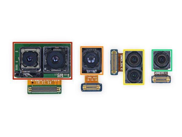

    • You probably could have spent your $2,000 USD on a pretty nice DSLR or mirrorless camera, so it's slightly appropriate that this phone folds six cameras into its frame. Consolation prize?
    • The only other time we've seen this many cameras in a smartphone teardown is Huawei's P30 Pro.
    • We line up the unblinking eyes:
    • Rear-facing 12 MP telephoto and 12 MP wide-angle cameras
    • Rear-facing 16 MP ultra-wide camera
    • "In-the-fold" 10 MP selfie cam (top) and 8 MP RGB depth cam
    • "Folded" front-facing 10 MP selfie cam

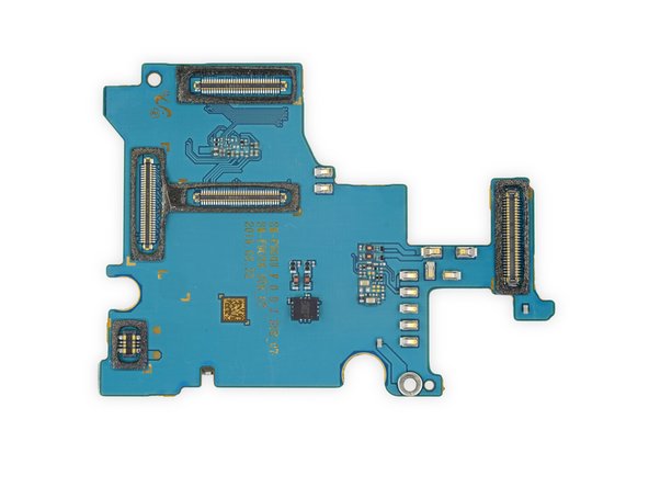

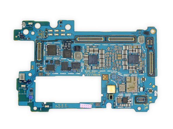

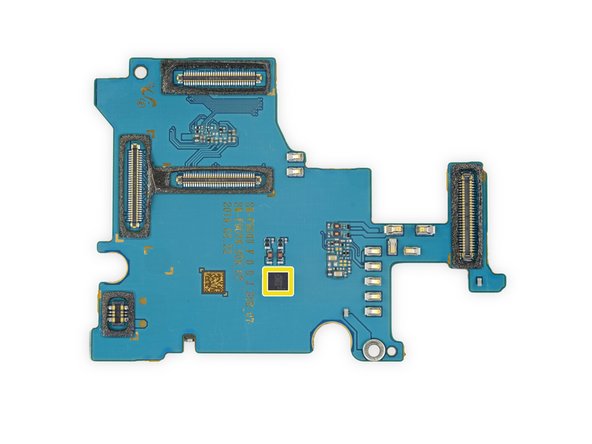

    • Let's check out the left-side board.
    • Are those silicone seals around the flex cable connectors? It sure looks like it. We first spotted these ingress-protection measures way back on the iPhone 6s, but they're not a common sight on Samsung products. When the chassis isn't water or dust-proof, this is how you build in a little board protection.
    • Meanwhile, here's the silicon we found on this board:
    • Samsung S2MPB02 camera power management
    • Samsung S2DOS05 display power management
    • Cirrus Logic CS35L40 haptic driver w/ digital signal processor
    • Cirrus Logic CS40L25 audio amplifier
    • Samsung S2ASL01 over-current protection (likely)

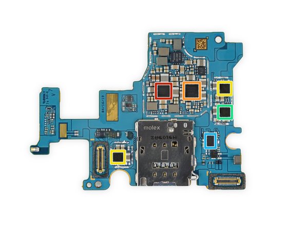

  11. Samsung Galaxy Fold Teardown: crwdns2935265:011crwdnd2935265:01crwdnd2935265:03crwdne2935265:0 Samsung Galaxy Fold Teardown: crwdns2935265:011crwdnd2935265:02crwdnd2935265:03crwdne2935265:0 Samsung Galaxy Fold Teardown: crwdns2935265:011crwdnd2935265:03crwdnd2935265:03crwdne2935265:0
    • SIM card PCB IC ID continued, plus bonus touchscreen chips:
    • Samsung S2DOS04 backlight controller (Likely)
    • NXP Semiconductor NCX2200 low voltage comparator
    • STMicroelectronics LSM6DSO accelerometer
    • STMicroelectronics FingerTip touch screen controller
    • GigaDevice GD25LH80C 8 Mb serial flash memory
    • Richtek RT8010 step down DC-DC converter

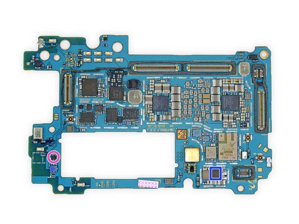

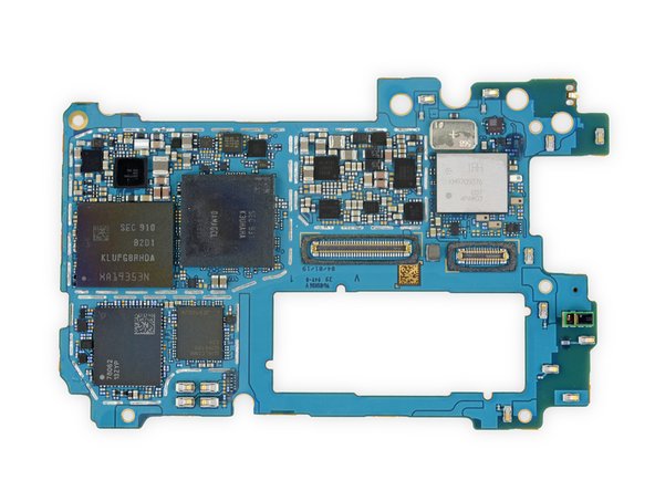

    • Double the phone, double the fun! Found on the right side's main board:
    • Samsung K3UHAHA0AM-AGCL 12 GB RAM layered over Qualcomm Snapdragon 855
    • Samsung KLUFG8RHDA-B2D1 512 GB eUFS NAND flash storage
    • Qorvo QM78062, likely a RF Fusion front-end module
    • Qualcomm SDR8150 RF transceiver
    • Murata KM9705076 front end module (likely)
    • Maxim MAX77705C PMIC
    • IDT P9320S Wireless charging IC
  13. Samsung Galaxy Fold Teardown: crwdns2935265:013crwdnd2935265:01crwdnd2935265:02crwdne2935265:0 Samsung Galaxy Fold Teardown: crwdns2935265:013crwdnd2935265:02crwdnd2935265:02crwdne2935265:0

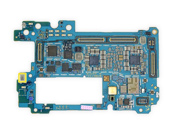

    • Main PCB IC ID, part 2:
    • STMicroelectronics ST33G1M2 32-Bit ARM Cortex-M3 secure microcontroller
    • STMicroelectronics STM32G071EB 32-Bit ARM Cortex-M0+ microcontroller w/ 128 Kb flash
    • Samsung S2MPB03 camera power management
    • Samsung S2MIS01 Magnetic Secure Transmission (MST) driver
    • Vishay DG2730 480 Mbps DPDT analog switch
    • Qualcomm QET5100 envelope tracker
    • NXP Semiconductor BGU8103 GPS/GLONASS/Galileo/COMPASS

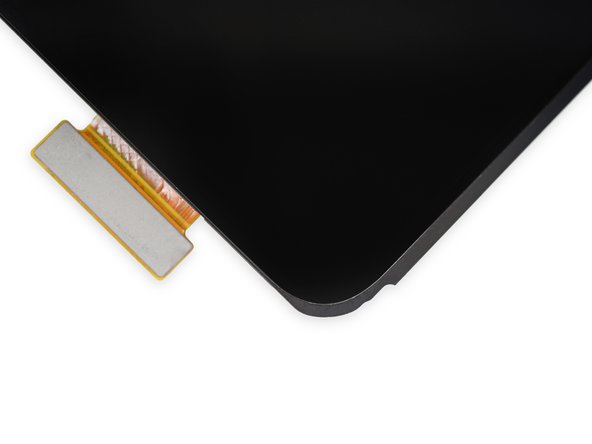

    • Now bezel-less, the screen is primed for prying off! We didn't need any heat last time, but today it seems Samsung isn't taking chances—they want this screen to stay put, and have added an extra sticky strip of black tar goop.
    • The screen is still adhered only along the outer edges—probably to allow the screen to float as it opens and folds.
    • For once, the relative difficulty of replacing the screen is not even our biggest beef. You wouldn't even have to drop this thing to break it, meaning screen replacements seem inevitable, and that's a scary thought.
    • Samsung generously offers to replace it for just $149—but only once, so make sure you use a light touch.
    • Granted, using plastic instead of glass as an OLED substrate means this display is less likely to shatter—but there are other modes of failure.
    • A single ultra-wide display cable connects the display to the board.
    • That means The Verge's reported "jelly scrolling" was probably due to the display driver software, not a split display.
    • Could they have updated the display driver for the second launch? Absolutely! Did we turn ours on to test before we took it apart? You ask too many questions.

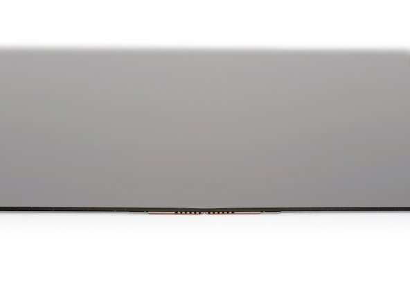

    • Well, well—this must be the reinforced screen we've heard so much about. And we do indeed find an extra metal layer, like chainmail armor between the backing plates and the display.
    • Backing the new notched armor layer are the aforementioned metal support plates, whose edges are adhered to the phone's frame. This leaves the center spine free of adhesive for a wider-radius fold.
    • All this metal makes the display surprisingly rigid, even when separated from the chassis.
    • Once removed from the chassis, the display looks completely flat, with no fold or scoring in sight.

    • Next up: the magic hinge that makes all of this folding wizardry possible, looking pretty similar to the last Fold we saw. Let's count it down:
    • Four spring-loaded clasps lock the display in the "open" position. The system is well-engineered and likely to last a long while.
    • Two hinges, secured to the spine—one at the top and one at the bottom—allow for some horizontal play in order to absorb any torsion force.
    • One center hinge, which sports a gear system. This distributes the opening force equally, ensuring that the two halves of the phone open synchronously.
    • The two well-routed flex cables serve as a corpus callosum between the phone halves. Each end of the cable is held securely in place before the bend, giving the cable room to flex freely.
    • Routing flex cables through hinges is a serious reliability concern over the long haul. This one looks designed to hold up—but if it doesn't, at least the cable itself is modular, unlike some others we've seen.
    • And here's that beautiful spine in motion!
    • At the top: the single rounded sliding hinge.
    • Just below that: one of the springy clasps, for latching the phone open.
    • And towards the bottom: the gear array, stabilizing the center and distributing force.
    • Samsung says they folded these phones more than 200,000 times, and with this hinge system we don't doubt it. But we think it's safe to say that humans aren't quite as gentle as Samsung's robots are? Plus, even a different robot couldn't achieve the same results.

    • We found covers over the gaps on either side of the display crease and tape around the inside of the hinge, both working to keep debris away from the backside of the display.
    • For further reinforcement, there's an extra layer of metal bonded to the back of the display.
    • Last but not least, the screen protector is slightly larger, hiding its tempting edges beneath the plastic bezel.
    • That said, this thing is still pretty fragile. We'll have to see how it holds up in the real world, but for now we can't help but wonder: why weren't these revisions a part of the first Fold? It took reviewers (and us) less than a week to figure out the phone's weak points. Why ship something they must have known to be so easily breakable?
    • While the phone is easier to get into than some, it still seems alarmingly fragile—a bad sign for repair.

    • Battery replacements are possible, but unnecessarily difficult—solvents help, but risk damage to the display supports.
    • Glued-down glass both front and back means greater risk of breakage, and makes repairs difficult to start.
