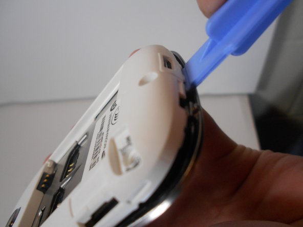

  1. Samsung Galaxy Fame S6812i Speaker Replacement, Remove the Battery Cover: crwdns2935265:01crwdnd2935265:01crwdnd2935265:02crwdne2935265:0 Samsung Galaxy Fame S6812i Speaker Replacement, Remove the Battery Cover: crwdns2935265:01crwdnd2935265:02crwdnd2935265:02crwdne2935265:0
    • Locate the small indent in the top of the device and use your nails or the plastic opening tool to separate the cover from the mid-frame.

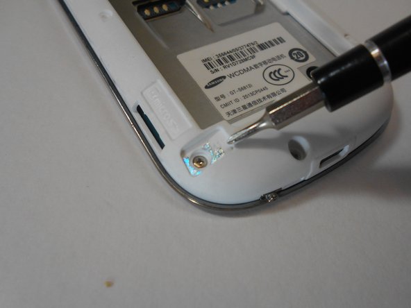

  3. Samsung Galaxy Fame S6812i Speaker Replacement, Remove the Mid-Frame: crwdns2935265:03crwdnd2935265:01crwdnd2935265:03crwdne2935265:0 Samsung Galaxy Fame S6812i Speaker Replacement, Remove the Mid-Frame: crwdns2935265:03crwdnd2935265:02crwdnd2935265:03crwdne2935265:0 Samsung Galaxy Fame S6812i Speaker Replacement, Remove the Mid-Frame: crwdns2935265:03crwdnd2935265:03crwdnd2935265:03crwdne2935265:0
    • Remove the five 3mm screws along the top and bottom edges of the device with the Philips #00 screwdriver.
    • One of these will be hidden under a piece of reflective foil. Breaking this will void the warranty.

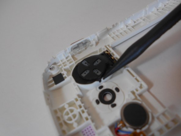

    • Use the plastic removal tool to work pry the mid-frame from the device.
    • This may take some effort, so try working around the edges slowly as to not break anything.

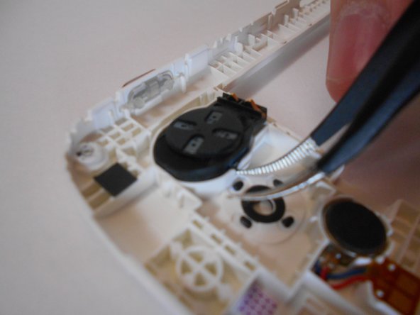

  4. Samsung Galaxy Fame S6812i Speaker Replacement, Remove the Damaged Speaker: crwdns2935265:04crwdnd2935265:01crwdnd2935265:03crwdne2935265:0 Samsung Galaxy Fame S6812i Speaker Replacement, Remove the Damaged Speaker: crwdns2935265:04crwdnd2935265:02crwdnd2935265:03crwdne2935265:0 Samsung Galaxy Fame S6812i Speaker Replacement, Remove the Damaged Speaker: crwdns2935265:04crwdnd2935265:03crwdnd2935265:03crwdne2935265:0
    • Lift the speaker from the phone using your fingers or tweezers.
