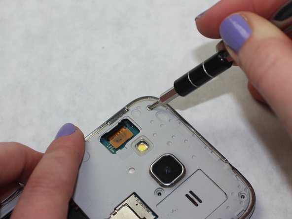

  6. Samsung Galaxy Core Prime Volume Buttons Replacement, Volume Button: crwdns2935265:06crwdnd2935265:01crwdnd2935265:02crwdne2935265:0 Samsung Galaxy Core Prime Volume Buttons Replacement, Volume Button: crwdns2935265:06crwdnd2935265:02crwdnd2935265:02crwdne2935265:0
    • Use a Phillips #00 screwdriver to remove the eight 4mm screws from the midframe.

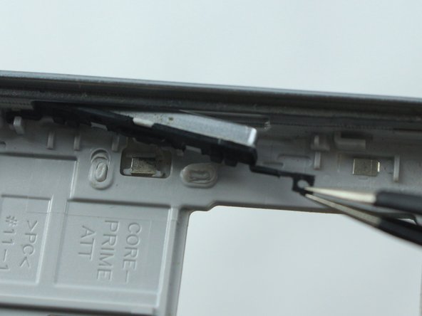

    • Use tweezers to unhook both of the rubber fixtures holding the volume button to the frame.
