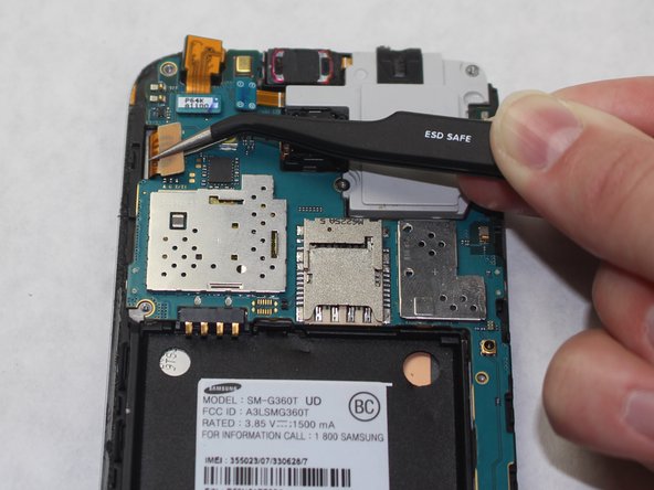

  10. Samsung Galaxy Core Prime Home Button  Replacement: crwdns2935265:010crwdnd2935265:01crwdnd2935265:02crwdne2935265:0 Samsung Galaxy Core Prime Home Button  Replacement: crwdns2935265:010crwdnd2935265:02crwdnd2935265:02crwdne2935265:0
    • Disconnect the LCD screen/touch screen ribbon from the motherboard using tweezers.
