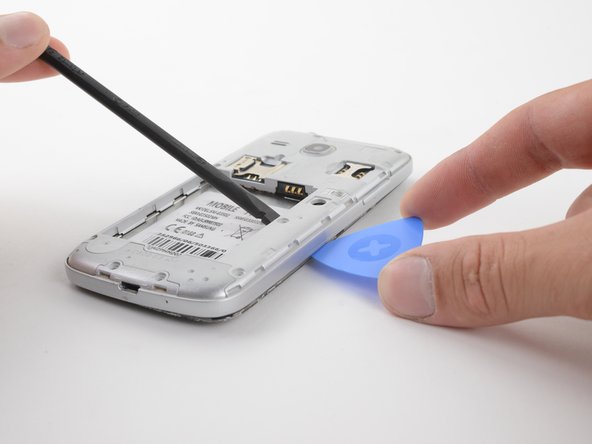

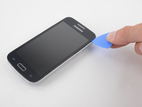

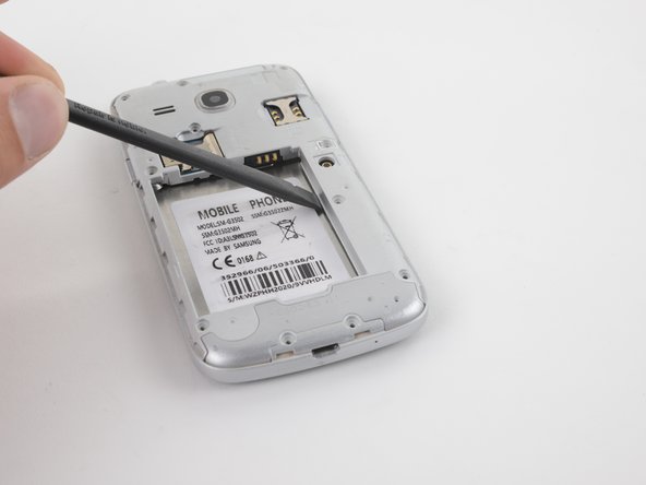

    • Insert the flat side of a spudger into the gap next to the power button.
    • The back cover is held by plastic clips. Pry the cover away from the phone until the clips release.
  2. Samsung Galaxy Core Plus Motherboard Replacement: crwdns2935265:02crwdnd2935265:01crwdnd2935265:03crwdne2935265:0 Samsung Galaxy Core Plus Motherboard Replacement: crwdns2935265:02crwdnd2935265:02crwdnd2935265:03crwdne2935265:0 Samsung Galaxy Core Plus Motherboard Replacement: crwdns2935265:02crwdnd2935265:03crwdnd2935265:03crwdne2935265:0

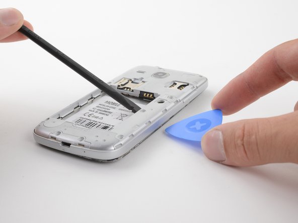

    • Insert an opening pick between the phone and the back cover.
    • Slide the opening pick along the perimeter of the cover.
    • Continue to release the clips by prying away from the phone.

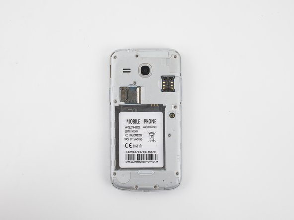

  3. Samsung Galaxy Core Plus Motherboard Replacement: crwdns2935265:03crwdnd2935265:01crwdnd2935265:02crwdne2935265:0 Samsung Galaxy Core Plus Motherboard Replacement: crwdns2935265:03crwdnd2935265:02crwdnd2935265:02crwdne2935265:0
    • Once all of the clips have been released, remove the back cover by hand.

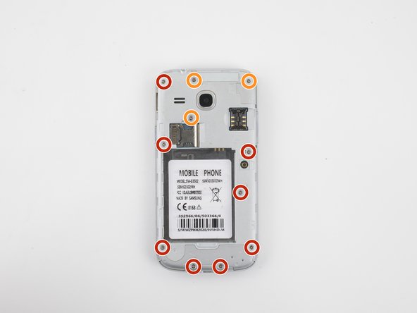

  5. Samsung Galaxy Core Plus Motherboard Replacement, Remove screws from the midframe: crwdns2935265:05crwdnd2935265:01crwdnd2935265:02crwdne2935265:0 Samsung Galaxy Core Plus Motherboard Replacement, Remove screws from the midframe: crwdns2935265:05crwdnd2935265:02crwdnd2935265:02crwdne2935265:0
    • Use a Phillips #00 screwdriver to remove eleven T3 screws from the midframe.
    • There are eight 4mm screws on the left and bottom of the midframe.
    • There are three 3.9mm screws in the upper right of the midframe.

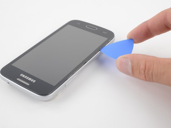

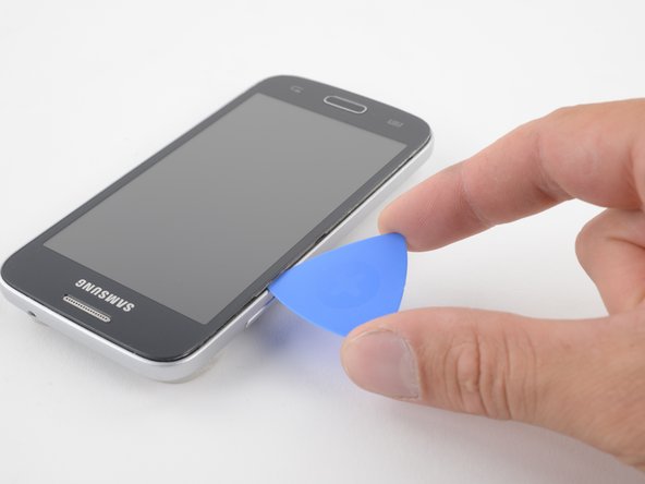

  6. Samsung Galaxy Core Plus Motherboard Replacement, Heat the front of the phone: crwdns2935265:06crwdnd2935265:01crwdnd2935265:01crwdne2935265:0
    • Heat an iOpener and apply it to the front of the device for two minutes. This will loosen the adhesive around the perimeter of the screen.
    • A hair dryer, heat gun, or hot plate may also be used. Be careful when applying heat—the display is susceptible to damage.

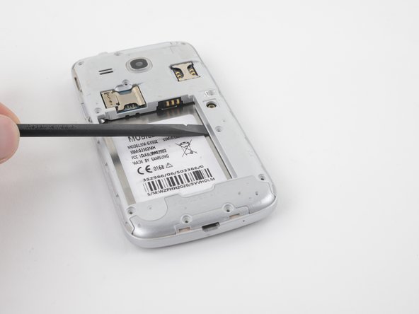

  7. Samsung Galaxy Core Plus Motherboard Replacement, Loosen the midframe from the screen: crwdns2935265:07crwdnd2935265:01crwdnd2935265:02crwdne2935265:0 Samsung Galaxy Core Plus Motherboard Replacement, Loosen the midframe from the screen: crwdns2935265:07crwdnd2935265:02crwdnd2935265:02crwdne2935265:0
    • Insert a spudger under the midframe and pry upward.
    • You may pry along any side of the battery recess. The right side and top side will be the easiest.
    • Do not pry near any connectors or black plastic parts. These will not separate with the midframe.

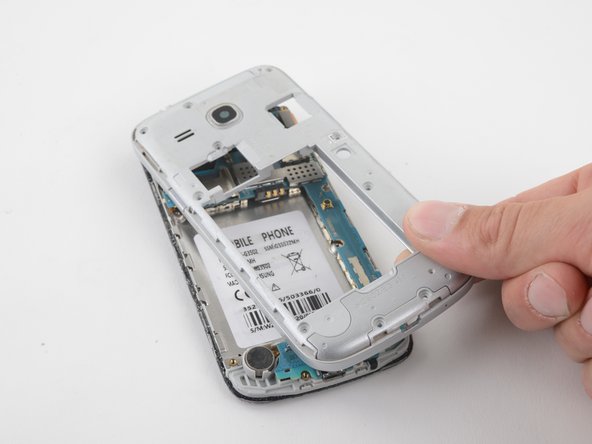

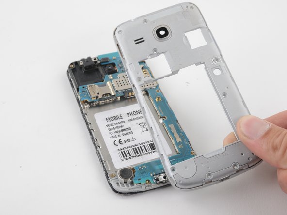

  10. Samsung Galaxy Core Plus Motherboard Replacement, Remove the midframe: crwdns2935265:010crwdnd2935265:01crwdnd2935265:02crwdne2935265:0 Samsung Galaxy Core Plus Motherboard Replacement, Remove the midframe: crwdns2935265:010crwdnd2935265:02crwdnd2935265:02crwdne2935265:0
    • Once the adhesive between the midframe and screen has been cut, the midframe will be free.
    • Grab and pull the midframe away from the phone.

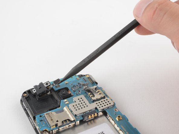

  11. Samsung Galaxy Core Plus Motherboard Replacement, Disconnect the headphone jack: crwdns2935265:011crwdnd2935265:01crwdnd2935265:02crwdne2935265:0 Samsung Galaxy Core Plus Motherboard Replacement, Disconnect the headphone jack: crwdns2935265:011crwdnd2935265:02crwdnd2935265:02crwdne2935265:0
    • Use a spudger to release the press-fit connector from the motherboard.
    • The press-fit connector is the only thing holding the headphone jack in place. Be careful not to lose this piece when it comes off.

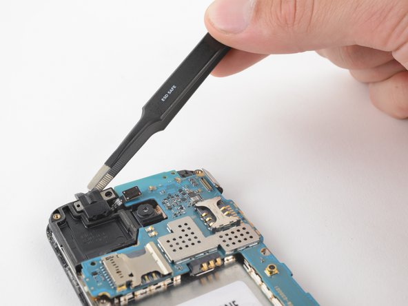

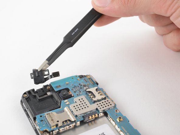

  12. Samsung Galaxy Core Plus Motherboard Replacement, Remove the headphone jack: crwdns2935265:012crwdnd2935265:01crwdnd2935265:02crwdne2935265:0 Samsung Galaxy Core Plus Motherboard Replacement, Remove the headphone jack: crwdns2935265:012crwdnd2935265:02crwdnd2935265:02crwdne2935265:0
    • Using a pair of blunt-nose tweezers or your fingers, remove the headphone jack.

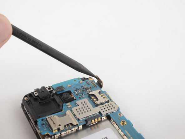

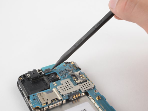

  13. Samsung Galaxy Core Plus Motherboard Replacement, Disconnect the display connector: crwdns2935265:013crwdnd2935265:01crwdnd2935265:02crwdne2935265:0 Samsung Galaxy Core Plus Motherboard Replacement, Disconnect the display connector: crwdns2935265:013crwdnd2935265:02crwdnd2935265:02crwdne2935265:0
    • Use a spudger to flick open the press-fit connector located in the upper right of the phone.

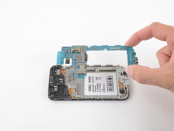

  14. Samsung Galaxy Core Plus Motherboard Replacement, Remove the motherboard: crwdns2935265:014crwdnd2935265:01crwdnd2935265:02crwdne2935265:0 Samsung Galaxy Core Plus Motherboard Replacement, Remove the motherboard: crwdns2935265:014crwdnd2935265:02crwdnd2935265:02crwdne2935265:0
    • Simply grab and lift the motherboard from the phone. There are no screws or cables holding it in place.
