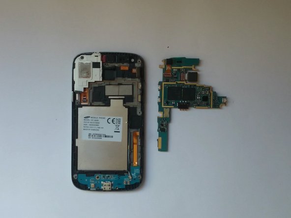

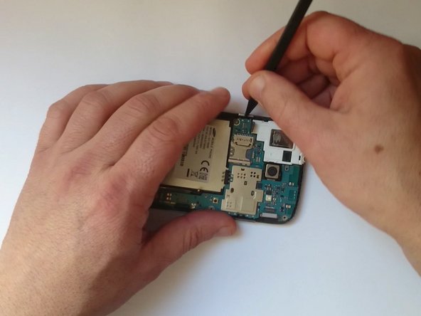

  3. Samsung Galaxy Core Logic Board Replacement, Logic Board: crwdns2935265:03crwdnd2935265:01crwdnd2935265:03crwdne2935265:0 Samsung Galaxy Core Logic Board Replacement, Logic Board: crwdns2935265:03crwdnd2935265:02crwdnd2935265:03crwdne2935265:0 Samsung Galaxy Core Logic Board Replacement, Logic Board: crwdns2935265:03crwdnd2935265:03crwdnd2935265:03crwdne2935265:0
    • Disconnect one by one:
    • Earpiece/Loudspeaker/Audio Jack connector module flex cable
    • LCD Display flex cable
    • Charging Dock/Antenna/Mic module flex cable
    • Coaxial Antenna cable
    • Carefully remove the Logic Board.
