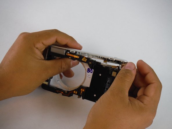

    • Having completed the previous guides up to this point you should be left with the chassis and internal frame exposed
  15. Samsung Galaxy Camera 2 Power button and Zoom button assembly Replacement: crwdns2935265:015crwdnd2935265:01crwdnd2935265:03crwdne2935265:0 Samsung Galaxy Camera 2 Power button and Zoom button assembly Replacement: crwdns2935265:015crwdnd2935265:02crwdnd2935265:03crwdne2935265:0 Samsung Galaxy Camera 2 Power button and Zoom button assembly Replacement: crwdns2935265:015crwdnd2935265:03crwdnd2935265:03crwdne2935265:0

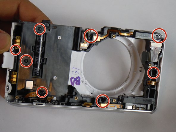

    • Start by removing nine (4mm, PH00) of the screws which hold the outer silver trim bezels to the main chassis highlighted in red.

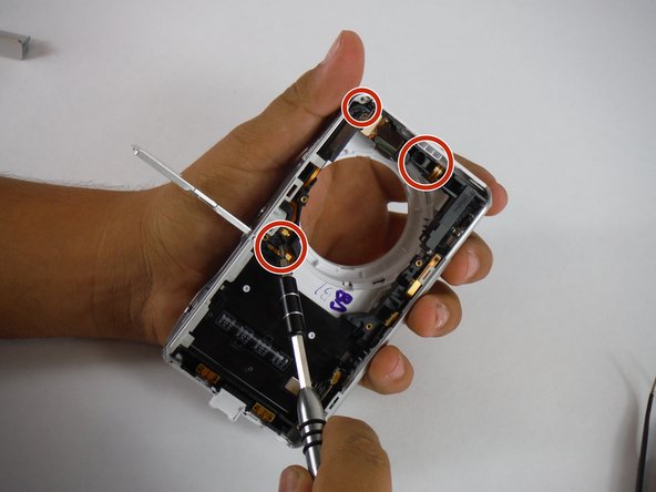

  16. Samsung Galaxy Camera 2 Power button and Zoom button assembly Replacement: crwdns2935265:016crwdnd2935265:01crwdnd2935265:02crwdne2935265:0 Samsung Galaxy Camera 2 Power button and Zoom button assembly Replacement: crwdns2935265:016crwdnd2935265:02crwdnd2935265:02crwdne2935265:0
    • First remove the silver trim bezel on the battery-door side which should pop straight out. The silver trim on the flash side requires the removal of two hidden screw (2mm, PH00) on the underside of the top of the camera. one is above the lense hole, and the other is by the spring on the flash side of the camera. They are marked in red.
    • With the screw removed, gently pull up on the silver trim to release one side. It will still be attached to the camera until the next step.

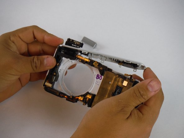

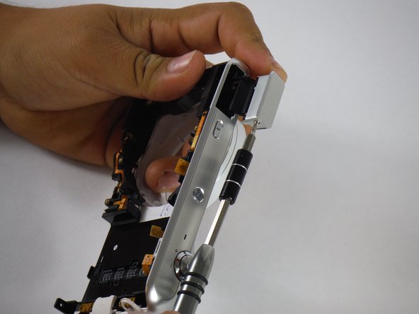

  17. Samsung Galaxy Camera 2 Power button and Zoom button assembly Replacement: crwdns2935265:017crwdnd2935265:01crwdnd2935265:03crwdne2935265:0 Samsung Galaxy Camera 2 Power button and Zoom button assembly Replacement: crwdns2935265:017crwdnd2935265:02crwdnd2935265:03crwdne2935265:0 Samsung Galaxy Camera 2 Power button and Zoom button assembly Replacement: crwdns2935265:017crwdnd2935265:03crwdnd2935265:03crwdne2935265:0
    • Open the flash and remove the silver plastic cap on the flash which has two screws (3mm, PH00). They are on either side and marked in red.
    • Then, use your hands to completely remove the silver trim containing the zoom and power buttons.

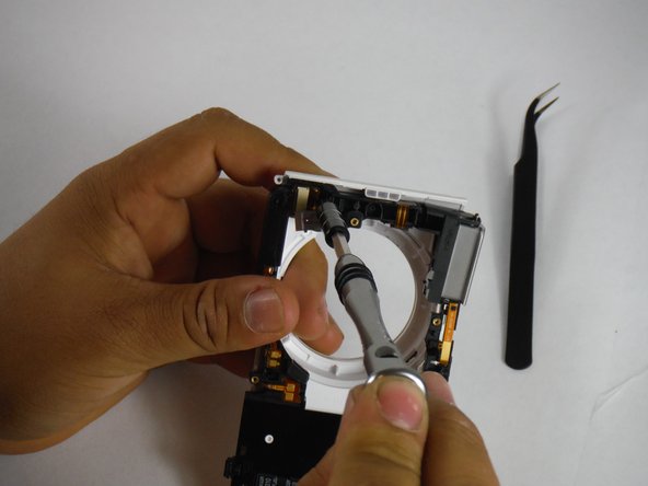

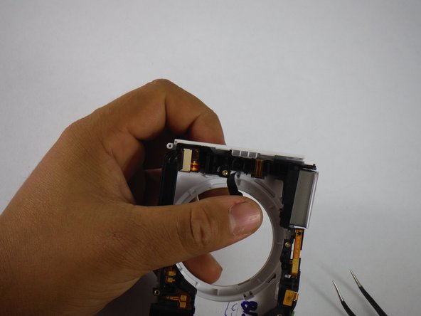

  18. Samsung Galaxy Camera 2 Power button and Zoom button assembly Replacement: crwdns2935265:018crwdnd2935265:01crwdnd2935265:03crwdne2935265:0 Samsung Galaxy Camera 2 Power button and Zoom button assembly Replacement: crwdns2935265:018crwdnd2935265:02crwdnd2935265:03crwdne2935265:0 Samsung Galaxy Camera 2 Power button and Zoom button assembly Replacement: crwdns2935265:018crwdnd2935265:03crwdnd2935265:03crwdne2935265:0
    • Using the iFIXIT curved nose tweezers, gently remove the ribbon cable for the flash. Doing so will reveal yet another hidden screw. Remove this with the iFIXIT screwdriver and PH00 bit to release the flash assembly.

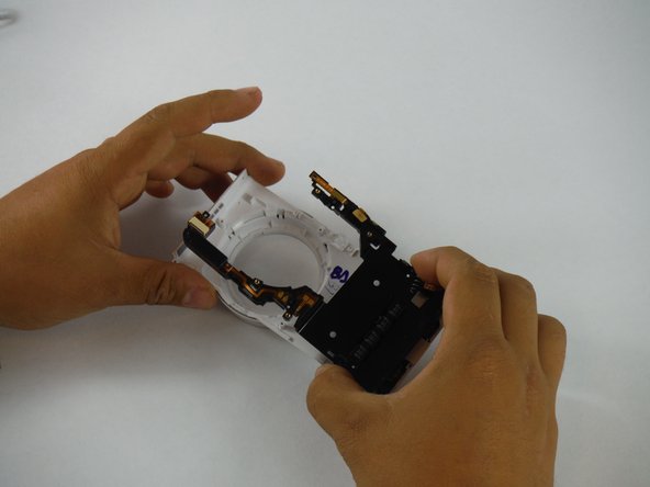

  19. Samsung Galaxy Camera 2 Power button and Zoom button assembly Replacement: crwdns2935265:019crwdnd2935265:01crwdnd2935265:03crwdne2935265:0 Samsung Galaxy Camera 2 Power button and Zoom button assembly Replacement: crwdns2935265:019crwdnd2935265:02crwdnd2935265:03crwdne2935265:0 Samsung Galaxy Camera 2 Power button and Zoom button assembly Replacement: crwdns2935265:019crwdnd2935265:03crwdnd2935265:03crwdne2935265:0

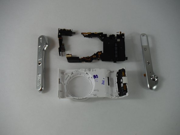

    • Take the flash assembly and set it aside while you complete the tear down of the camera.
    • With the flash assembly removed, gently pull the rest of the internal frame away from the casing to expose every last piece of the camera.

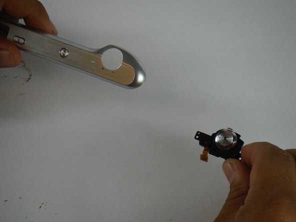

  20. Samsung Galaxy Camera 2 Power button and Zoom button assembly Replacement: crwdns2935265:020crwdnd2935265:01crwdnd2935265:03crwdne2935265:0 Samsung Galaxy Camera 2 Power button and Zoom button assembly Replacement: crwdns2935265:020crwdnd2935265:02crwdnd2935265:03crwdne2935265:0 Samsung Galaxy Camera 2 Power button and Zoom button assembly Replacement: crwdns2935265:020crwdnd2935265:03crwdnd2935265:03crwdne2935265:0

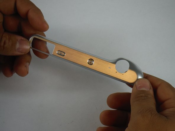

    • Now with the camera completely disassembled, take the silver trim with the zoom and find the two screws holding the zoom-button assembly.
  21. Samsung Galaxy Camera 2 Power button and Zoom button assembly Replacement: crwdns2935265:021crwdnd2935265:01crwdnd2935265:01crwdne2935265:0
    • Shown are the component pieces.
