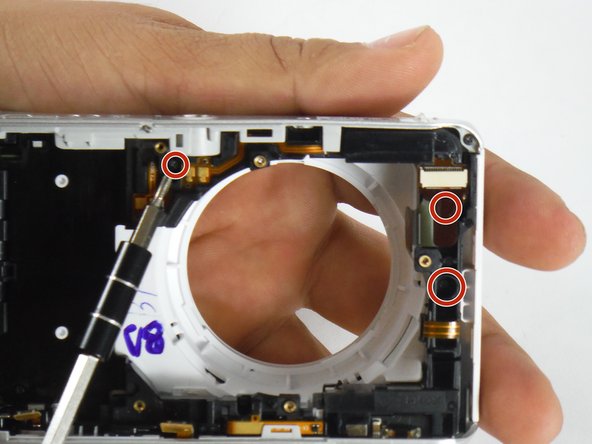

  16. Samsung Galaxy Camera 2 Flash Replacement: crwdns2935265:016crwdnd2935265:01crwdnd2935265:03crwdne2935265:0 Samsung Galaxy Camera 2 Flash Replacement: crwdns2935265:016crwdnd2935265:02crwdnd2935265:03crwdne2935265:0 Samsung Galaxy Camera 2 Flash Replacement: crwdns2935265:016crwdnd2935265:03crwdnd2935265:03crwdne2935265:0
    • Before you can take out the black frame, make sure to remove the silver accents on the casing. Use the plastic opening tool to gently pry them off.
    • Although not necessary, it is advisable to remove the silver cover from the flash. Take out the two screws holding it together and gently pop off the top with the plastic opening tool. We chose to put it back on for the rest of the guide to add stability to the piece.

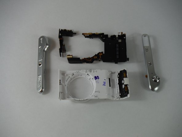

  17. Samsung Galaxy Camera 2 Flash Replacement: crwdns2935265:017crwdnd2935265:01crwdnd2935265:03crwdne2935265:0 Samsung Galaxy Camera 2 Flash Replacement: crwdns2935265:017crwdnd2935265:02crwdnd2935265:03crwdne2935265:0 Samsung Galaxy Camera 2 Flash Replacement: crwdns2935265:017crwdnd2935265:03crwdnd2935265:03crwdne2935265:0
    • Next, gently use the plastic opening tool to pry the black frame out of the casing. The frame should lift out easily. If you feel some resistance, you may have missed a screw.

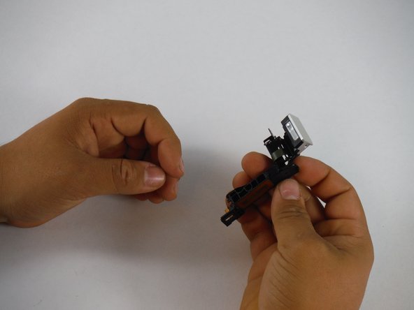

  18. Samsung Galaxy Camera 2 Flash Replacement: crwdns2935265:018crwdnd2935265:01crwdnd2935265:02crwdne2935265:0 Samsung Galaxy Camera 2 Flash Replacement: crwdns2935265:018crwdnd2935265:02crwdnd2935265:02crwdne2935265:0
    • Now, looking at the black frame, the top left corner is the flash mechanism.
    • Taking out the two (3mm PH00) screws from the plastic flash cap frees the light bulb so that it can be changed.
