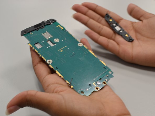

    1. Samsung Galaxy Amp 2 Home Button Replacement, Motherboard: crwdns2935265:06crwdnd2935265:01crwdnd2935265:03crwdne2935265:0 Samsung Galaxy Amp 2 Home Button Replacement, Motherboard: crwdns2935265:06crwdnd2935265:02crwdnd2935265:03crwdne2935265:0 Samsung Galaxy Amp 2 Home Button Replacement, Motherboard: crwdns2935265:06crwdnd2935265:03crwdnd2935265:03crwdne2935265:0
      • Unscrew the nine 4.5mm PH screws using a screwdriver with a PH000 bit.
      • Push from the back panel to remove the bottom part of the motherboard.
      • Push from the front panel to remove the top part of the motherboard.

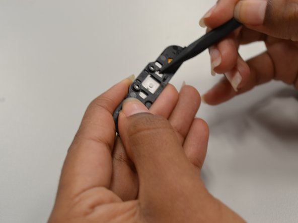

    1. Samsung Galaxy Amp 2 Home Button Replacement, Home Button: crwdns2935265:07crwdnd2935265:01crwdnd2935265:03crwdne2935265:0 Samsung Galaxy Amp 2 Home Button Replacement, Home Button: crwdns2935265:07crwdnd2935265:02crwdnd2935265:03crwdne2935265:0 Samsung Galaxy Amp 2 Home Button Replacement, Home Button: crwdns2935265:07crwdnd2935265:03crwdnd2935265:03crwdne2935265:0
      • Pull the black tab that is located on the bottom of the motherboard.
      • Push the home button out of the black tab.
