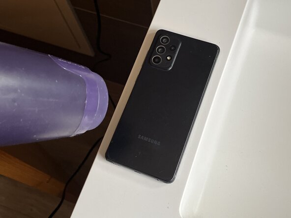

  1. Samsung Galaxy A52s Back cover Replacement, Heating the phone: crwdns2935265:01crwdnd2935265:01crwdnd2935265:01crwdne2935265:0
    • With a hair dryer, heat gun or heat back heat the back cover evenly.
    • Be careful with hair dryers/heat guns as if you heat the device for too long, you might cause serious harm to the phone.
    • Heat the device for around 4 minutes, or until you feel you can open it

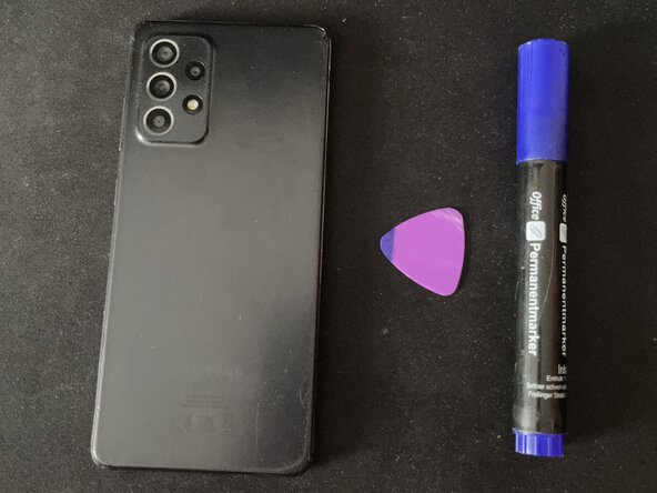

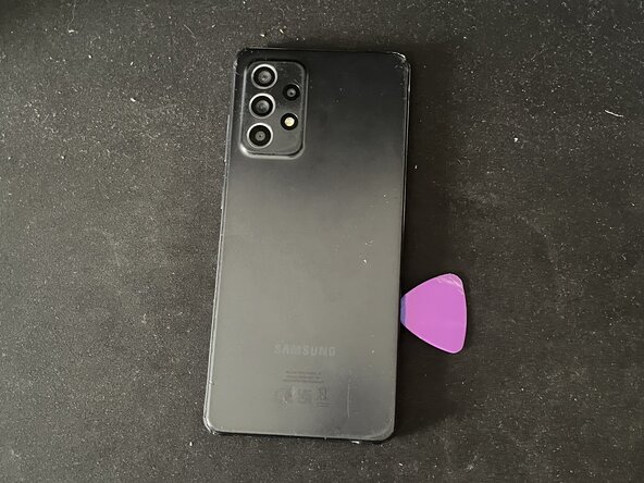

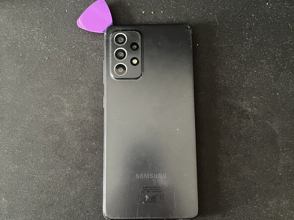

  2. Samsung Galaxy A52s Back cover Replacement, Opening the phone: crwdns2935265:02crwdnd2935265:01crwdnd2935265:03crwdne2935265:0 Samsung Galaxy A52s Back cover Replacement, Opening the phone: crwdns2935265:02crwdnd2935265:02crwdnd2935265:03crwdne2935265:0 Samsung Galaxy A52s Back cover Replacement, Opening the phone: crwdns2935265:02crwdnd2935265:03crwdnd2935265:03crwdne2935265:0
    • Mark 5 milimeters on your pick with a marker. This is the most you can go without damaging internal components like the camera.
    • Put the pick between the back cover and the frame, and go around the phone to loosen the adhesive.

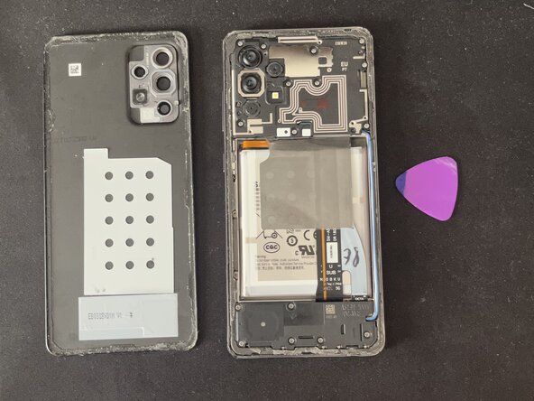

  3. Samsung Galaxy A52s Back cover Replacement, Final step: crwdns2935265:03crwdnd2935265:01crwdnd2935265:01crwdne2935265:0
    • Your A52s 5G is now open. You can put the new back cover on the device (apply glue or just stick it on if there is glue already applied on the brand new cover)
To reassemble the device, either re-apply glue or just press on the back cover while it is put on the device.
