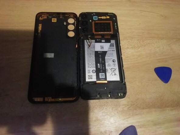

  1. Samsung Galaxy A14 Screen Replacement, Open the phone.: crwdns2935265:02crwdnd2935265:01crwdnd2935265:02crwdne2935265:0 Samsung Galaxy A14 Screen Replacement, Open the phone.: crwdns2935265:02crwdnd2935265:02crwdnd2935265:02crwdne2935265:0
    • Take your prying tool. Pick any area of the phone. The best areas are below the volume buttons and above the camera and begin to make your way around the phone. This may be a bit difficult but it is the hardest part of the repair, it gets easier. Open the phone like a book once you loosen the screen completely.

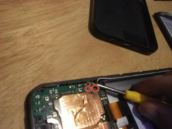

  2. Samsung Galaxy A14 Screen Replacement, Remove Upper Panel and Disconnect upper wiring.: crwdns2935265:03crwdnd2935265:01crwdnd2935265:03crwdne2935265:0 Samsung Galaxy A14 Screen Replacement, Remove Upper Panel and Disconnect upper wiring.: crwdns2935265:03crwdnd2935265:02crwdnd2935265:03crwdne2935265:0 Samsung Galaxy A14 Screen Replacement, Remove Upper Panel and Disconnect upper wiring.: crwdns2935265:03crwdnd2935265:03crwdnd2935265:03crwdne2935265:0
    • Unscrew the top panel and take it off. Disconnect the battery wire (Black wire connecting to the battery, right of the screen wires.)
    • Disconnect screen wires. (Black and orange wires coming from the bottom of the device, right of the battery wire)
  3. Samsung Galaxy A14 Screen Replacement, Remove Bottom Panel and Bottom Wiring.: crwdns2935265:04crwdnd2935265:01crwdnd2935265:02crwdne2935265:0 Samsung Galaxy A14 Screen Replacement, Remove Bottom Panel and Bottom Wiring.: crwdns2935265:04crwdnd2935265:02crwdnd2935265:02crwdne2935265:0
    • Unscrew the bottom panel.
    • Disconnect the long black and white wires at the upper part of the device and bottom part. You can pull them out of the casing and set them aside. When putting these back later, make sure they are nice and snug.
    • Disconnect the bottom LCD wire. It is orange and black and near the right.
    • Remove the bottom board.
  4. Samsung Galaxy A14 Screen Replacement, Removing the batteries.: crwdns2935265:05crwdnd2935265:01crwdnd2935265:01crwdne2935265:0
    • Remove the battery very very carefully. If you think the battery is damaged throw it out asap. A punctured battery can result in fire and/or explosion. The battery may be a bit difficult. Use alcohol if the adhesive is too strong. Ignore the bottom motherboard in the photo, it should be removed by now for you.
    • Remove the vibrate motor at the bottom right, where the charging port board was previously located. You may need some alcohol to break down the adhesive holding down the orange wire. Set it aside.
