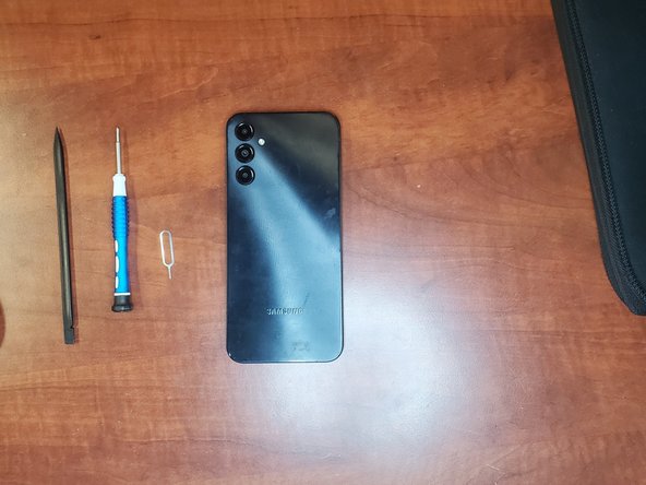

  1. Samsung Galaxy A14 5G Teardown, Remove Sim Tray: crwdns2935265:01crwdnd2935265:01crwdnd2935265:01crwdne2935265:0
    • Remove Sim Card & SD Card Tray with a Sim Ejector Tool
  2. Samsung Galaxy A14 5G Teardown, Pop Out Back Cover: crwdns2935265:02crwdnd2935265:01crwdnd2935265:03crwdne2935265:0 Samsung Galaxy A14 5G Teardown, Pop Out Back Cover: crwdns2935265:02crwdnd2935265:02crwdnd2935265:03crwdne2935265:0 Samsung Galaxy A14 5G Teardown, Pop Out Back Cover: crwdns2935265:02crwdnd2935265:03crwdnd2935265:03crwdne2935265:0
    • Pop out the back cover using a spudger or opening pick

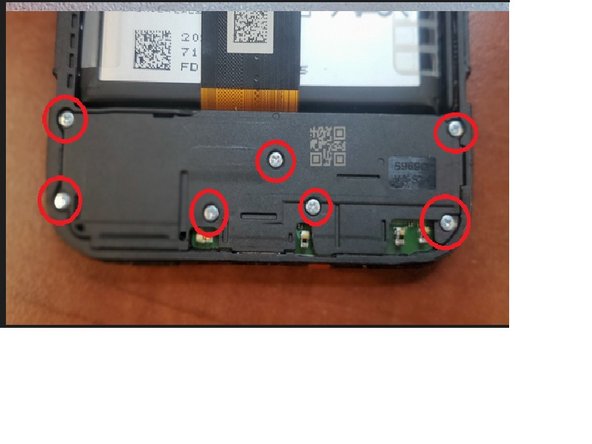

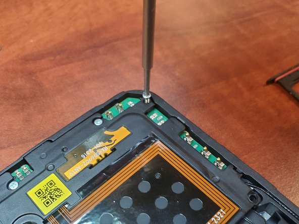

  4. Samsung Galaxy A14 5G Teardown, Unscrew All 16 Screws: crwdns2935265:04crwdnd2935265:01crwdnd2935265:03crwdne2935265:0 Samsung Galaxy A14 5G Teardown, Unscrew All 16 Screws: crwdns2935265:04crwdnd2935265:02crwdnd2935265:03crwdne2935265:0 Samsung Galaxy A14 5G Teardown, Unscrew All 16 Screws: crwdns2935265:04crwdnd2935265:03crwdnd2935265:03crwdne2935265:0
    • Unscrew all 16 screws on the plates
  5. Samsung Galaxy A14 5G Teardown: crwdns2935265:05crwdnd2935265:01crwdnd2935265:02crwdne2935265:0 Samsung Galaxy A14 5G Teardown: crwdns2935265:05crwdnd2935265:02crwdnd2935265:02crwdne2935265:0
    • Pop off the 2 plates holding on the Motherboard and Charging Port

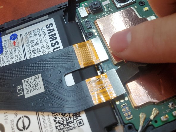

  6. Samsung Galaxy A14 5G Teardown, Unplug Cables: crwdns2935265:06crwdnd2935265:01crwdnd2935265:03crwdne2935265:0 Samsung Galaxy A14 5G Teardown, Unplug Cables: crwdns2935265:06crwdnd2935265:02crwdnd2935265:03crwdne2935265:0 Samsung Galaxy A14 5G Teardown, Unplug Cables: crwdns2935265:06crwdnd2935265:03crwdnd2935265:03crwdne2935265:0
    • Unplug the battery, display cables, and fingerprint scanner from the Phone

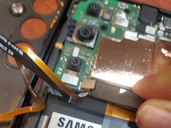

  7. Samsung Galaxy A14 5G Teardown, Unplug Front Camera & Antenna Cables: crwdns2935265:07crwdnd2935265:01crwdnd2935265:03crwdne2935265:0 Samsung Galaxy A14 5G Teardown, Unplug Front Camera & Antenna Cables: crwdns2935265:07crwdnd2935265:02crwdnd2935265:03crwdne2935265:0 Samsung Galaxy A14 5G Teardown, Unplug Front Camera & Antenna Cables: crwdns2935265:07crwdnd2935265:03crwdnd2935265:03crwdne2935265:0
    • Unplug the front camera & Antenna Cables from the phone

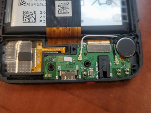

  8. Samsung Galaxy A14 5G Teardown, Unplug Charging Port: crwdns2935265:08crwdnd2935265:01crwdnd2935265:01crwdne2935265:0
    • Unplug the Charging Port from the Display Cable and Antenna Cables
  9. Samsung Galaxy A14 5G Teardown, Remove Charging Port: crwdns2935265:09crwdnd2935265:01crwdnd2935265:01crwdne2935265:0
    • Pry Up on the Charging Port
  10. Samsung Galaxy A14 5G Teardown, Remove Motherboard: crwdns2935265:010crwdnd2935265:01crwdnd2935265:01crwdne2935265:0
    • Pry Up on the Motherboard

181 crwdns2915208:0crwdne2915208:0
What is the black square the connects the speaker.
Judy LeBrun - crwdns2934203:0crwdne2934203:0
it is a foam pad

FadingBulb57227 -
what is the white cable? what is the black cable? specifically, please : -)
