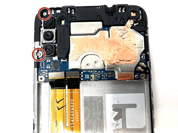

  8. Samsung Galaxy A11 Front Facing Camera Replacement, Motherboard: crwdns2935265:08crwdnd2935265:01crwdnd2935265:01crwdne2935265:0
    • Remove the five 3 mm silver and black screws from the top of the device using a Phillips #000 screwdriver.

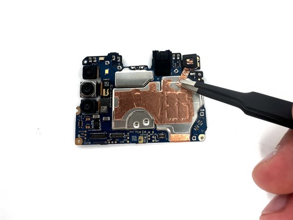

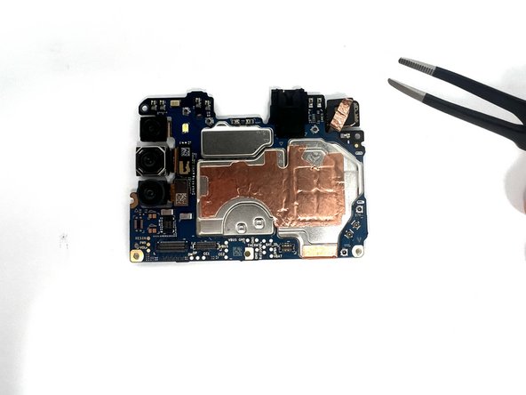

  11. Samsung Galaxy A11 Front Facing Camera Replacement, Front Facing Camera: crwdns2935265:011crwdnd2935265:01crwdnd2935265:03crwdne2935265:0 Samsung Galaxy A11 Front Facing Camera Replacement, Front Facing Camera: crwdns2935265:011crwdnd2935265:02crwdnd2935265:03crwdne2935265:0 Samsung Galaxy A11 Front Facing Camera Replacement, Front Facing Camera: crwdns2935265:011crwdnd2935265:03crwdnd2935265:03crwdne2935265:0
    • Gently use tweezers to peel up the copper strip that spans from the front facing camera to the motherboard.
    • If you are using metal tweezers, be gentle in order to avoid damaging the device.

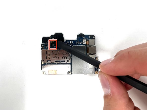

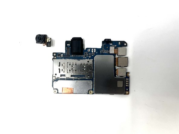

    • Flip the motherboard over.
    • Using a spudger, disconnect the front facing camera from the motherboard.
