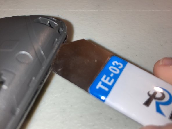

  3. Samsung GT-E1205Q Teardown, Screws: crwdns2935265:03crwdnd2935265:01crwdnd2935265:03crwdne2935265:0 Samsung GT-E1205Q Teardown, Screws: crwdns2935265:03crwdnd2935265:02crwdnd2935265:03crwdne2935265:0 Samsung GT-E1205Q Teardown, Screws: crwdns2935265:03crwdnd2935265:03crwdnd2935265:03crwdne2935265:0
    • Now, unscrew the three Phillips screws with a PH#000 screwdriver and use an opening tool to work your way around the edges to get the back-off.
    • Be careful not to hurt yourself with the opening tool! (See Photo 3)

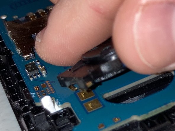

  4. Samsung GT-E1205Q Teardown, Parts to Remove: crwdns2935265:04crwdnd2935265:01crwdnd2935265:02crwdne2935265:0 Samsung GT-E1205Q Teardown, Parts to Remove: crwdns2935265:04crwdnd2935265:02crwdnd2935265:02crwdne2935265:0
    • On the back of the phone, we can remove the vibration motor and then on the circuit board, you can remove the speaker.

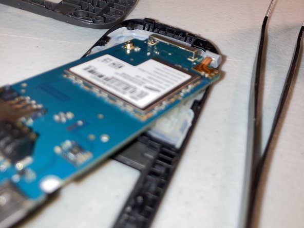

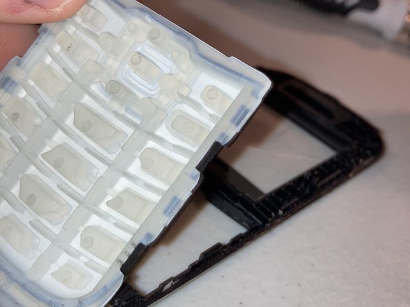

  5. Samsung GT-E1205Q Teardown, Board & Alpha-Numeric Keypad: crwdns2935265:05crwdnd2935265:01crwdnd2935265:03crwdne2935265:0 Samsung GT-E1205Q Teardown, Board & Alpha-Numeric Keypad: crwdns2935265:05crwdnd2935265:02crwdnd2935265:03crwdne2935265:0 Samsung GT-E1205Q Teardown, Board & Alpha-Numeric Keypad: crwdns2935265:05crwdnd2935265:03crwdnd2935265:03crwdne2935265:0
    • Now, pull up on the top of the board, use tweezers to push the bottom right clip in, and then pull the board to the right and up. Next, remove the fake keypad.

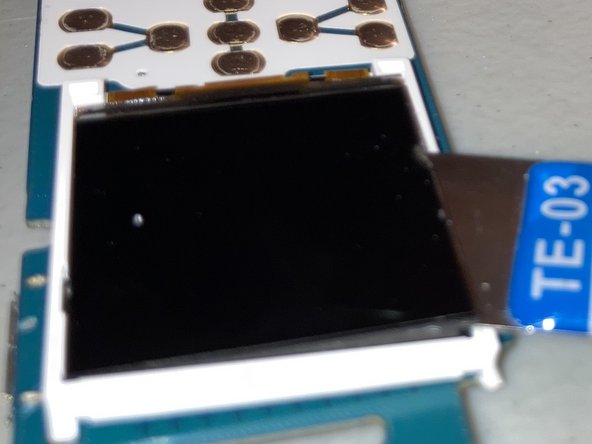

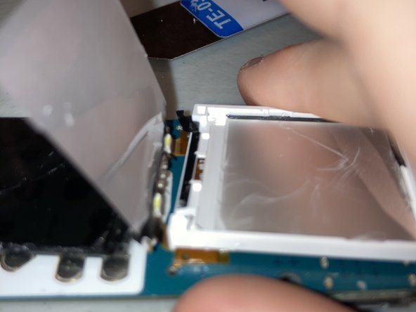

  6. Samsung GT-E1205Q Teardown, Screen: crwdns2935265:06crwdnd2935265:01crwdnd2935265:03crwdne2935265:0 Samsung GT-E1205Q Teardown, Screen: crwdns2935265:06crwdnd2935265:02crwdnd2935265:03crwdne2935265:0 Samsung GT-E1205Q Teardown, Screen: crwdns2935265:06crwdnd2935265:03crwdnd2935265:03crwdne2935265:0
    • Now, unclip the two white clips on the board, flip the board over and ever so carefully push an opening tool UNDER the screen and lift, CAREFULLY! Then remove the white plastic piece that WAS under the screen.
    • WARNING! Be careful not to crack or shatter the LCD screen because the liquid crystal inside it is TOXIC!
