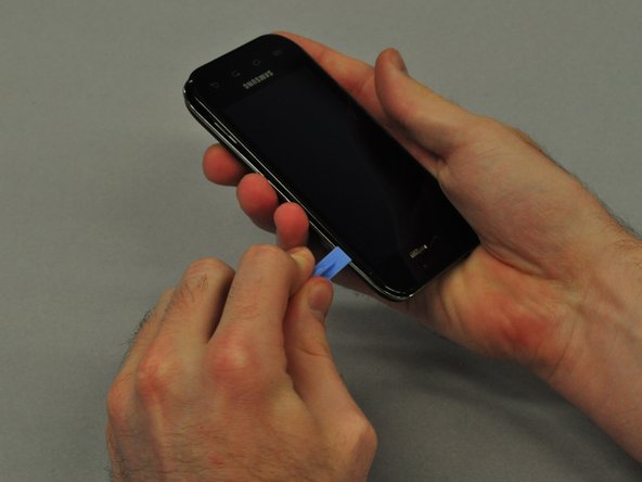

    • To remove the back case of the Samsung Galaxy S, you may need a spudger.
    • Identify the slit which is at the bottom edge of the phone.
  2. Samsung Fascinate Speaker Replacement: crwdns2935265:02crwdnd2935265:01crwdnd2935265:02crwdne2935265:0 Samsung Fascinate Speaker Replacement: crwdns2935265:02crwdnd2935265:02crwdnd2935265:02crwdne2935265:0
    • Insert the edge of the spudger into the slit and use it to pry the back case off of the phone.

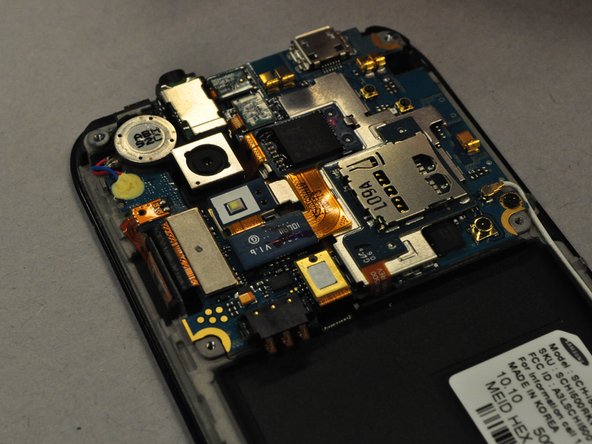

  3. Samsung Fascinate Speaker Replacement, Battery: crwdns2935265:03crwdnd2935265:01crwdnd2935265:02crwdne2935265:0 Samsung Fascinate Speaker Replacement, Battery: crwdns2935265:03crwdnd2935265:02crwdnd2935265:02crwdne2935265:0
    • Insert the spudger into the space between the battery and the phone and pry the battery out as you slide it along the underside the battery.

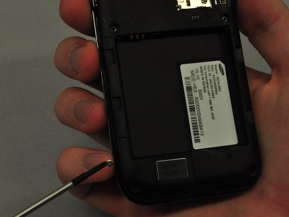

  4. Samsung Fascinate Speaker Replacement, Speaker: crwdns2935265:04crwdnd2935265:01crwdnd2935265:03crwdne2935265:0 Samsung Fascinate Speaker Replacement, Speaker: crwdns2935265:04crwdnd2935265:02crwdnd2935265:03crwdne2935265:0 Samsung Fascinate Speaker Replacement, Speaker: crwdns2935265:04crwdnd2935265:03crwdnd2935265:03crwdne2935265:0
    • Use the screwdriver to unscrew each of the 6 silver screws holding the main case to the LCD touchscreen.
    • If the screws are stuck, use the spudger to pry them out.

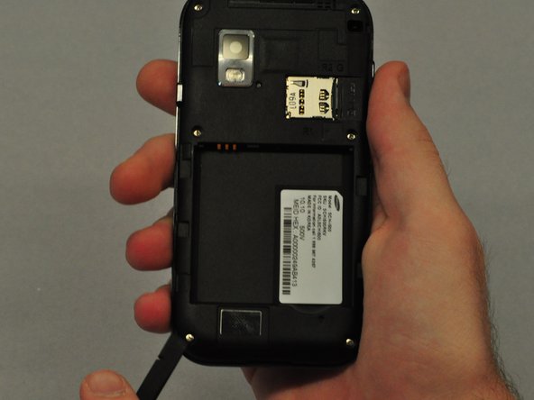

  5. Samsung Fascinate Speaker Replacement: crwdns2935265:05crwdnd2935265:01crwdnd2935265:03crwdne2935265:0 Samsung Fascinate Speaker Replacement: crwdns2935265:05crwdnd2935265:02crwdnd2935265:03crwdne2935265:0 Samsung Fascinate Speaker Replacement: crwdns2935265:05crwdnd2935265:03crwdnd2935265:03crwdne2935265:0

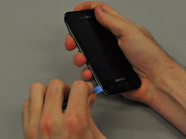

    • Use the plastic opening tool to pry the main case from the LCD touchscreen.
    • Insert the thin edge of the plastic opening tool into the groove between the silver edge and black edge.
    • Run the tool all the way around the edge of the phone until you hear each of the clips detach.

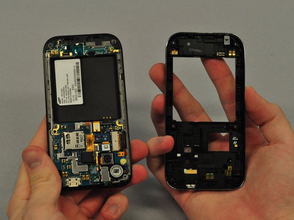

  6. Samsung Fascinate Speaker Replacement: crwdns2935265:06crwdnd2935265:01crwdnd2935265:03crwdne2935265:0 Samsung Fascinate Speaker Replacement: crwdns2935265:06crwdnd2935265:02crwdnd2935265:03crwdne2935265:0 Samsung Fascinate Speaker Replacement: crwdns2935265:06crwdnd2935265:03crwdnd2935265:03crwdne2935265:0
    • Once the clips are detached, separate the main case from the LCD touchscreen.

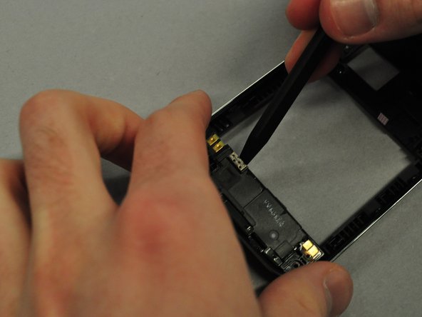

  7. Samsung Fascinate Speaker Replacement: crwdns2935265:07crwdnd2935265:01crwdnd2935265:03crwdne2935265:0 Samsung Fascinate Speaker Replacement: crwdns2935265:07crwdnd2935265:02crwdnd2935265:03crwdne2935265:0 Samsung Fascinate Speaker Replacement: crwdns2935265:07crwdnd2935265:03crwdnd2935265:03crwdne2935265:0

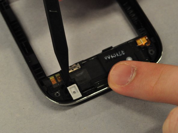

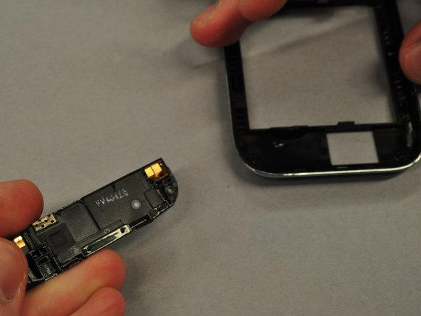

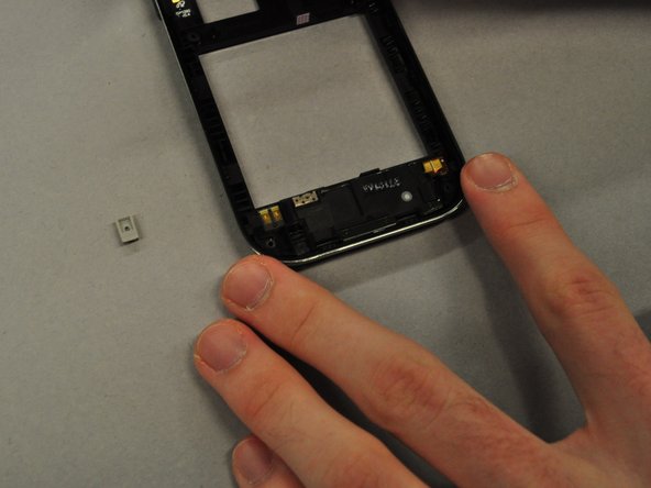

    • Use the spudger to pry out the grey rubber rectangular component from the main case.
  8. Samsung Fascinate Speaker Replacement: crwdns2935265:08crwdnd2935265:01crwdnd2935265:03crwdne2935265:0 Samsung Fascinate Speaker Replacement: crwdns2935265:08crwdnd2935265:02crwdnd2935265:03crwdne2935265:0 Samsung Fascinate Speaker Replacement: crwdns2935265:08crwdnd2935265:03crwdnd2935265:03crwdne2935265:0
    • Use the spudger to pry along the groove between the speaker and the main case.
    • Once the speaker is unclipped it should pop out easily.
