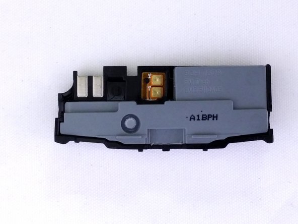

    1. Samsung Exhibit II 4G Loudspeaker Replacement, Loudspeaker: crwdns2935265:011crwdnd2935265:01crwdnd2935265:03crwdne2935265:0 Samsung Exhibit II 4G Loudspeaker Replacement, Loudspeaker: crwdns2935265:011crwdnd2935265:02crwdnd2935265:03crwdne2935265:0 Samsung Exhibit II 4G Loudspeaker Replacement, Loudspeaker: crwdns2935265:011crwdnd2935265:03crwdnd2935265:03crwdne2935265:0
      • Position Back Panel Assembly so the internal Loudspeaker unit is facing up.
      • With your index fingers and thumbs, grasp the Back Panel Assembly near the Loudspeaker.
      • Twist your palms inward to apply pressure against your index fingers.
      • The Loudspeaker will easily pop out.
