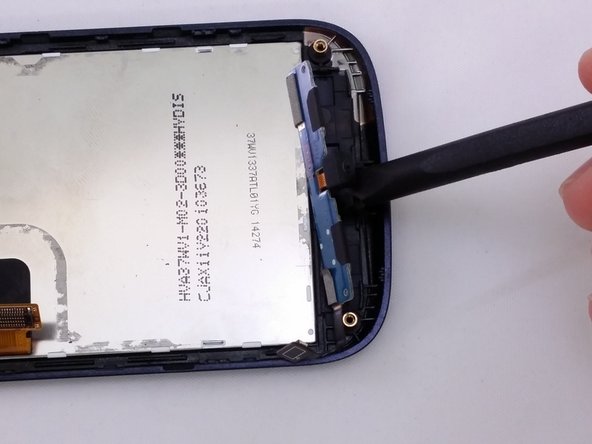

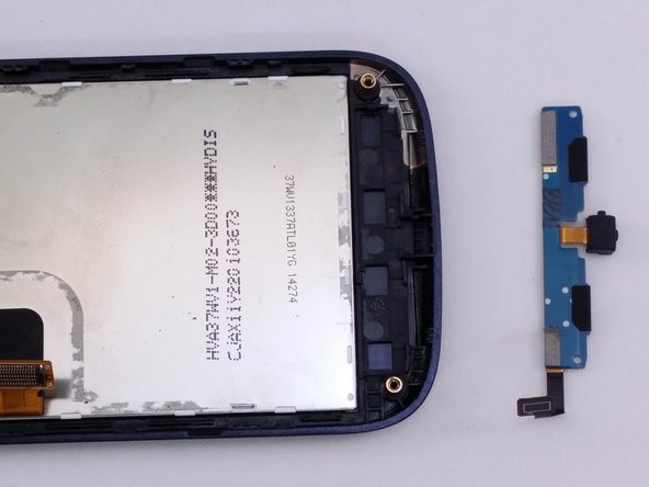

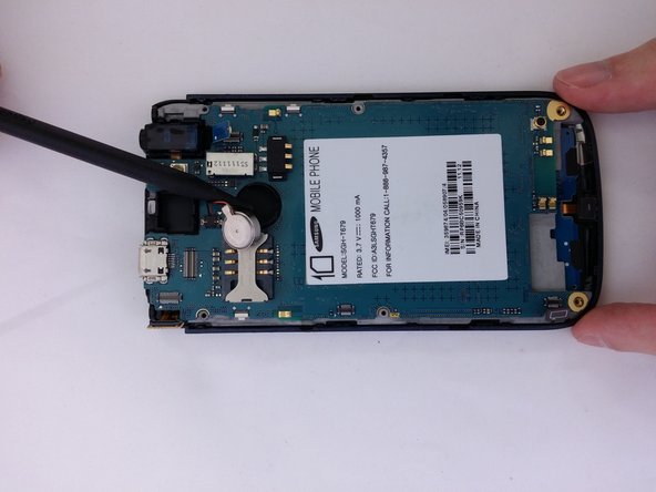

    1. Samsung Exhibit II 4G Display Assembly Replacement, Vibration Motor: crwdns2935265:011crwdnd2935265:01crwdnd2935265:02crwdne2935265:0 Samsung Exhibit II 4G Display Assembly Replacement, Vibration Motor: crwdns2935265:011crwdnd2935265:02crwdnd2935265:02crwdne2935265:0
      • Insert the pointed end of a spudger into the gap in the round housing frame.
      • Using spudger to remove vibrator remove from the adhesive.
    2. Samsung Exhibit II 4G Display Assembly Replacement: crwdns2935265:012crwdnd2935265:01crwdnd2935265:02crwdne2935265:0 Samsung Exhibit II 4G Display Assembly Replacement: crwdns2935265:012crwdnd2935265:02crwdnd2935265:02crwdne2935265:0
      • Use the flat end of a spudger to remove vibrator cable from motherboard.

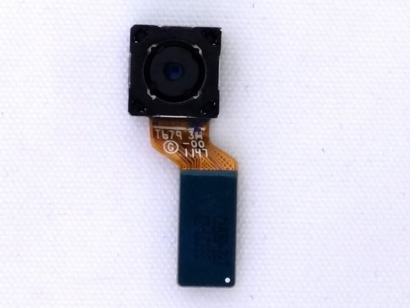

    1. Samsung Exhibit II 4G Display Assembly Replacement, Rear Facing Camera: crwdns2935265:013crwdnd2935265:01crwdnd2935265:01crwdne2935265:0
      • Use the flat end of a spudger to disconnect the camera assembly cable.
    2. Samsung Exhibit II 4G Display Assembly Replacement: crwdns2935265:014crwdnd2935265:01crwdnd2935265:02crwdne2935265:0 Samsung Exhibit II 4G Display Assembly Replacement: crwdns2935265:014crwdnd2935265:02crwdnd2935265:02crwdne2935265:0
      • Remove camera from square housing.

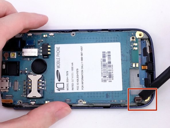

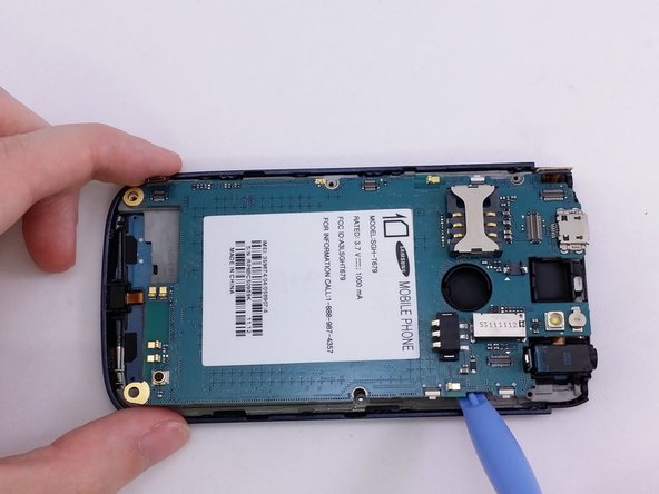

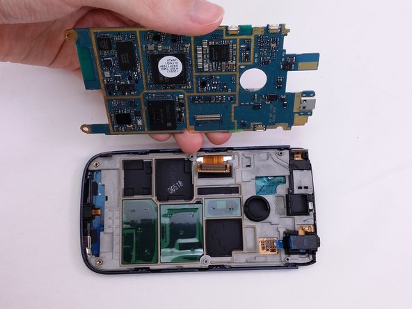

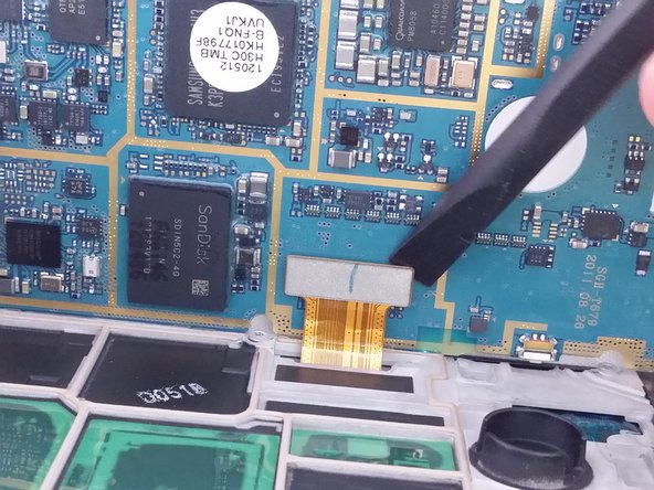

    1. Samsung Exhibit II 4G Display Assembly Replacement, Motherboard: crwdns2935265:015crwdnd2935265:01crwdnd2935265:03crwdne2935265:0 Samsung Exhibit II 4G Display Assembly Replacement, Motherboard: crwdns2935265:015crwdnd2935265:02crwdnd2935265:03crwdne2935265:0 Samsung Exhibit II 4G Display Assembly Replacement, Motherboard: crwdns2935265:015crwdnd2935265:03crwdnd2935265:03crwdne2935265:0
      • Insert the spudger under each corner ribbon cable and lift them out of the way.
      • Use care when lifting the ribbon cables.
      • Insert a plastic pry tool into the gap between motherboard and base of phone
    2. Samsung Exhibit II 4G Display Assembly Replacement: crwdns2935265:016crwdnd2935265:01crwdnd2935265:03crwdne2935265:0 Samsung Exhibit II 4G Display Assembly Replacement: crwdns2935265:016crwdnd2935265:02crwdnd2935265:03crwdne2935265:0 Samsung Exhibit II 4G Display Assembly Replacement: crwdns2935265:016crwdnd2935265:03crwdnd2935265:03crwdne2935265:0
      • Tilt the motherboard up carefully.
      • Be sure not to damage the ribbon cable still connected at the bottom of the motherboard.
      • Use a spudger to pry the connector from the socket on the motherboard.
      • Lift motherboard from frame.

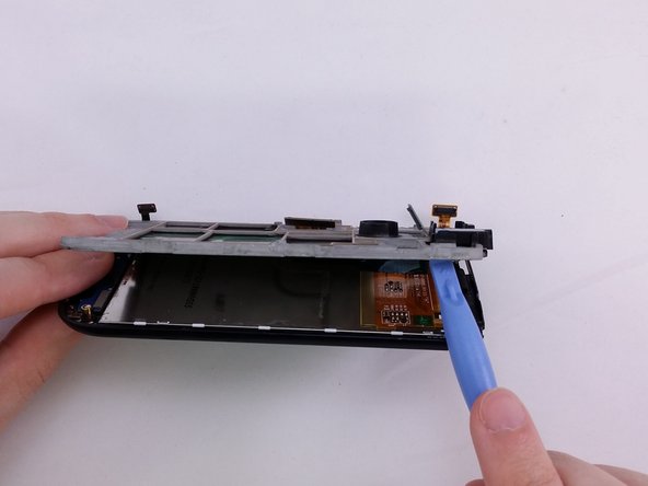

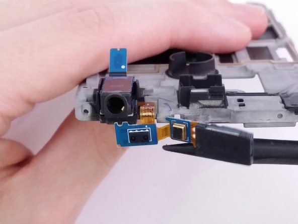

    1. Samsung Exhibit II 4G Display Assembly Replacement, Headphone Jack: crwdns2935265:017crwdnd2935265:01crwdnd2935265:03crwdne2935265:0 Samsung Exhibit II 4G Display Assembly Replacement, Headphone Jack: crwdns2935265:017crwdnd2935265:02crwdnd2935265:03crwdne2935265:0 Samsung Exhibit II 4G Display Assembly Replacement, Headphone Jack: crwdns2935265:017crwdnd2935265:03crwdnd2935265:03crwdne2935265:0
      • Insert flat end of spudger between support panel and front assembly.
      • Using a spudger pry up to create opening to insert plastic opening tool.
    2. Samsung Exhibit II 4G Display Assembly Replacement: crwdns2935265:018crwdnd2935265:01crwdnd2935265:02crwdne2935265:0 Samsung Exhibit II 4G Display Assembly Replacement: crwdns2935265:018crwdnd2935265:02crwdnd2935265:02crwdne2935265:0
      • Insert a plactic opening tool in opening.
      • Use plastic opening tool to pry around the edge of support panel to free it from front assembly.
    3. Samsung Exhibit II 4G Display Assembly Replacement: crwdns2935265:019crwdnd2935265:01crwdnd2935265:03crwdne2935265:0 Samsung Exhibit II 4G Display Assembly Replacement: crwdns2935265:019crwdnd2935265:02crwdnd2935265:03crwdne2935265:0 Samsung Exhibit II 4G Display Assembly Replacement: crwdns2935265:019crwdnd2935265:03crwdnd2935265:03crwdne2935265:0
      • Insert the pointed end of a spudger into gap.
      • Lift spudger away from support plate to remove headphone component.
    4. Samsung Exhibit II 4G Display Assembly Replacement: crwdns2935265:020crwdnd2935265:01crwdnd2935265:03crwdne2935265:0 Samsung Exhibit II 4G Display Assembly Replacement: crwdns2935265:020crwdnd2935265:02crwdnd2935265:03crwdne2935265:0 Samsung Exhibit II 4G Display Assembly Replacement: crwdns2935265:020crwdnd2935265:03crwdnd2935265:03crwdne2935265:0
      • Use the flat end of the spudger to remove headphone jack component from rectangular housing.

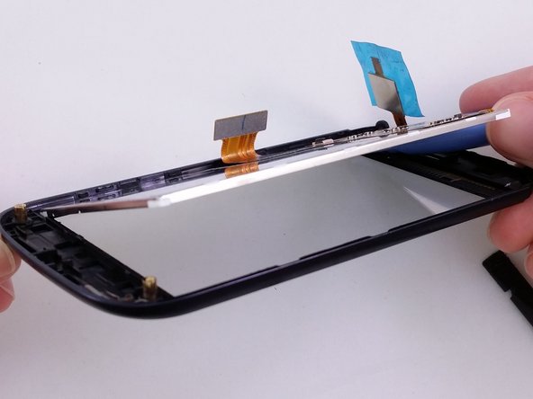

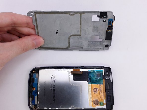

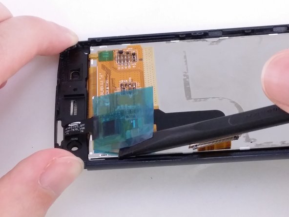

    1. Samsung Exhibit II 4G Display Assembly Replacement, Display Assembly: crwdns2935265:021crwdnd2935265:01crwdnd2935265:03crwdne2935265:0 Samsung Exhibit II 4G Display Assembly Replacement, Display Assembly: crwdns2935265:021crwdnd2935265:02crwdnd2935265:03crwdne2935265:0 Samsung Exhibit II 4G Display Assembly Replacement, Display Assembly: crwdns2935265:021crwdnd2935265:03crwdnd2935265:03crwdne2935265:0
      • The the flat end of a spudger between componet and frame.
      • Use the the spudger to lift the componet from the frame.

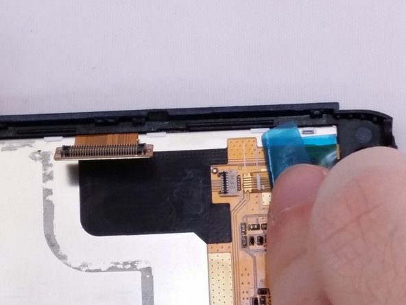

    2. Samsung Exhibit II 4G Display Assembly Replacement: crwdns2935265:022crwdnd2935265:01crwdnd2935265:03crwdne2935265:0 Samsung Exhibit II 4G Display Assembly Replacement: crwdns2935265:022crwdnd2935265:02crwdnd2935265:03crwdne2935265:0 Samsung Exhibit II 4G Display Assembly Replacement: crwdns2935265:022crwdnd2935265:03crwdnd2935265:03crwdne2935265:0
      • Insert the spudger between blue flim and the back of the LCD.
      • Using the spudger lift blue film away from LCD.

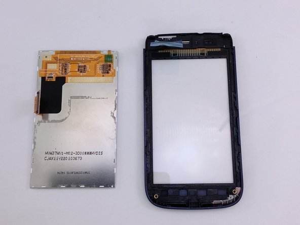

    3. Samsung Exhibit II 4G Display Assembly Replacement: crwdns2935265:023crwdnd2935265:01crwdnd2935265:03crwdne2935265:0 Samsung Exhibit II 4G Display Assembly Replacement: crwdns2935265:023crwdnd2935265:02crwdnd2935265:03crwdne2935265:0 Samsung Exhibit II 4G Display Assembly Replacement: crwdns2935265:023crwdnd2935265:03crwdnd2935265:03crwdne2935265:0
      • Notice ribbon cable slides under the tan square component.
    4. Samsung Exhibit II 4G Display Assembly Replacement: crwdns2935265:024crwdnd2935265:01crwdnd2935265:03crwdne2935265:0 Samsung Exhibit II 4G Display Assembly Replacement: crwdns2935265:024crwdnd2935265:02crwdnd2935265:03crwdne2935265:0 Samsung Exhibit II 4G Display Assembly Replacement: crwdns2935265:024crwdnd2935265:03crwdnd2935265:03crwdne2935265:0
      • Insert a plastic opening tool between LCD and Digitizer screen.
      • Use plastic opening tool to pry and lift the LCD from the glass screen.
      • Adhesive material around edge of LCD.
    5. Samsung Exhibit II 4G Display Assembly Replacement: crwdns2935265:025crwdnd2935265:01crwdnd2935265:02crwdne2935265:0 Samsung Exhibit II 4G Display Assembly Replacement: crwdns2935265:025crwdnd2935265:02crwdnd2935265:02crwdne2935265:0
      • Lift LCD away from digitizer screen.
