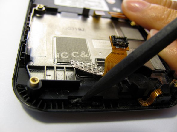

  14. Samsung Eternity Microphone Replacement: crwdns2935265:015crwdnd2935265:01crwdnd2935265:01crwdne2935265:0
    • Peel up the black tape on the bottom of the back case.
  15. Samsung Eternity Microphone Replacement: crwdns2935265:016crwdnd2935265:01crwdnd2935265:01crwdne2935265:0

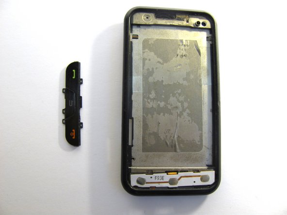

    • Use the spudger to release the front buttons from the phones frame.
    • Don't try and pull the front buttons completely away from the phone. There are clips that still are holding them to the phone.
  16. Samsung Eternity Microphone Replacement: crwdns2935265:017crwdnd2935265:01crwdnd2935265:03crwdne2935265:0 Samsung Eternity Microphone Replacement: crwdns2935265:017crwdnd2935265:02crwdnd2935265:03crwdne2935265:0 Samsung Eternity Microphone Replacement: crwdns2935265:017crwdnd2935265:03crwdnd2935265:03crwdne2935265:0
    • Use the spudger to remove three plastic lasso hooks that are holding the front buttons to the case.
    • The front button plastic assembly should come right off.
