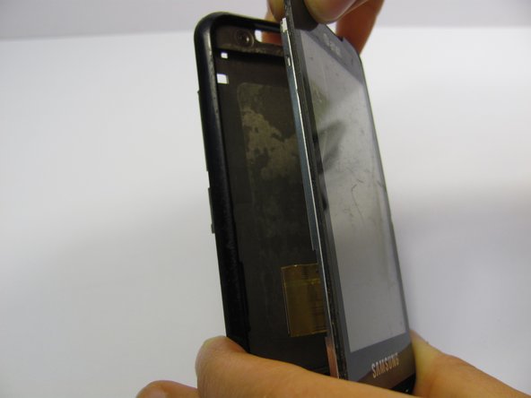

      • Flip the phone over so you are looking at the front screen of the phone.
    2. Samsung Eternity Digitizer and Screen Replacement: crwdns2935265:012crwdnd2935265:01crwdnd2935265:03crwdne2935265:0 Samsung Eternity Digitizer and Screen Replacement: crwdns2935265:012crwdnd2935265:02crwdnd2935265:03crwdne2935265:0 Samsung Eternity Digitizer and Screen Replacement: crwdns2935265:012crwdnd2935265:03crwdnd2935265:03crwdne2935265:0

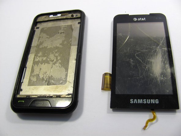

      • Use a small tool to pry the digitizer and screen (together) from the frame of the phone.
      • This may take some time and careful work because it is glued down to the frame.
      • Be careful when you pull the lower part of this piece away from the phone frame because there is a ribbon attached to the digitizer that you don't want to break. There is also a ribbon on the side of the screen to be aware of.

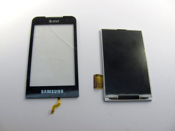

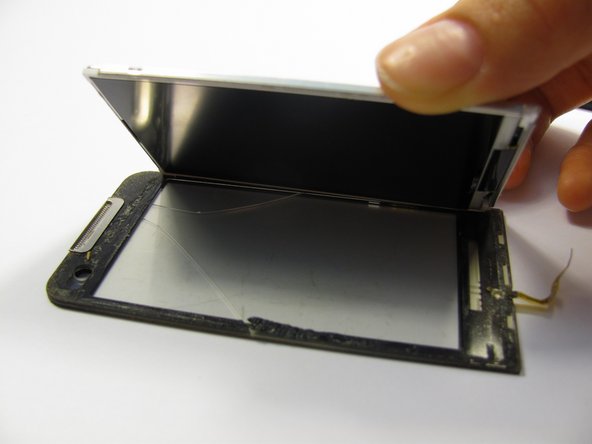

      • Next, carefully pull the digitizer away from the screen.
      • At this point you can replace either the screen or the digitizer.
      • Cleaning the screen with a glass cleaning cloth before reassembling will remove any smudges or fingerprints from disassembling the device.
