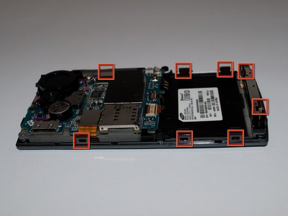

  5. Samsung Epix Speakers Replacement: crwdns2935265:05crwdnd2935265:01crwdnd2935265:02crwdne2935265:0 Samsung Epix Speakers Replacement: crwdns2935265:05crwdnd2935265:02crwdnd2935265:02crwdne2935265:0
    • Slide the iPod opening tool into the seam on the side of the phone and turn it slightly to unhook the eight clips.
    • There are three clips on each side and two at the bottom of the phone.
  6. Samsung Epix Speakers Replacement: crwdns2935265:06crwdnd2935265:01crwdnd2935265:01crwdne2935265:0
    • Once all eight of the clips have been unhooked, lift the back panel off of the phone.
    • Be careful not to remove the front panel. It is still connected to the phone chassis by a ribbon cable in the bottom right corner of the motherboard.
