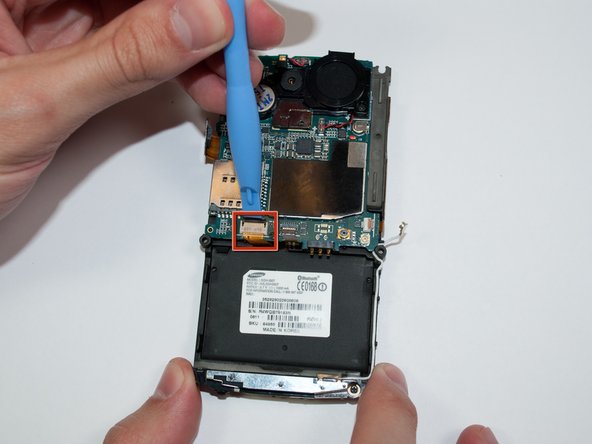

    • Unlatch and remove the front panel ribbon cable located at the bottom right of the motherboard.
  14. Samsung Epix Motherboard Replacement: crwdns2935265:014crwdnd2935265:01crwdnd2935265:01crwdne2935265:0
