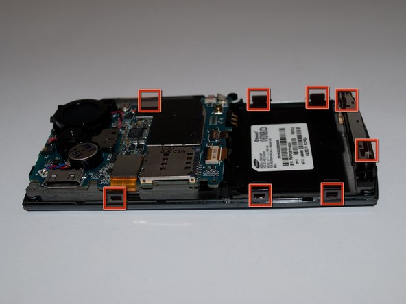

    3. Samsung Epix LCD Display Replacement: crwdns2935265:05crwdnd2935265:01crwdnd2935265:02crwdne2935265:0 Samsung Epix LCD Display Replacement: crwdns2935265:05crwdnd2935265:02crwdnd2935265:02crwdne2935265:0
      • Slide the opening tool along the seam on the side of the phone and turn it slightly to unhook the eight clips.
      • There are three clips on each side and two at the bottom of the phone.
    4. Samsung Epix LCD Display Replacement: crwdns2935265:06crwdnd2935265:01crwdnd2935265:01crwdne2935265:0
      • Once all eight of the clips have been unhooked, lift the back panel off of the phone.
      • Be careful not to remove the front panel. It will still be connected to the phone chassis by a ribbon cable on the motherboard.
