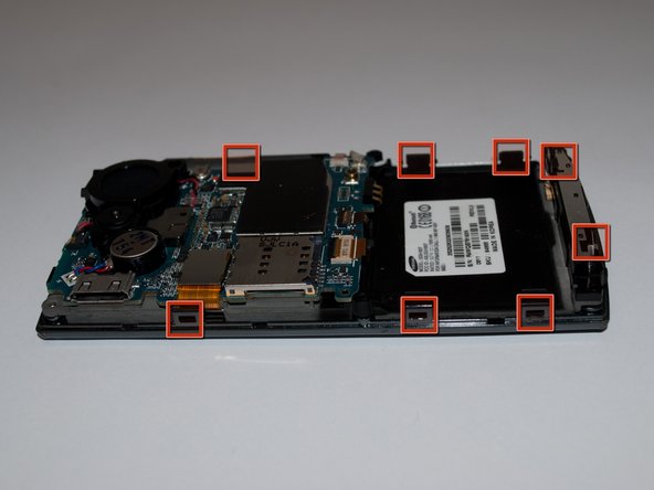

      • Insert the prying tool into the seam on the side of the phone and turn it slightly. Do this for each of the eight clips to unhook them
      • There are three clips on each side and two at the bottom of the phone.
    4. Samsung Epix Keyboard Replacement: crwdns2935265:06crwdnd2935265:01crwdnd2935265:01crwdne2935265:0
      • Once all eight of the clips have been unhooked, lift the back panel gently off of the phone.
      • Be careful and do not attempt to remove the front panel. It is still connected to the phone's chassis by a ribbon cable which is located in the bottom right side of the motherboard.
