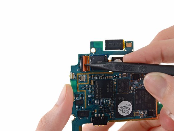

  15. Samsung Epic 4G Touch Rear Facing Camera Replacement, Motherboard Assembly: crwdns2935265:015crwdnd2935265:01crwdnd2935265:02crwdne2935265:0 Samsung Epic 4G Touch Rear Facing Camera Replacement, Motherboard Assembly: crwdns2935265:015crwdnd2935265:02crwdnd2935265:02crwdne2935265:0
    • Use the flat end of a spudger to disconnect the front-facing camera cable connector.

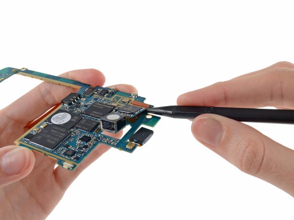

  21. Samsung Epic 4G Touch Rear Facing Camera Replacement, Rear Facing Camera: crwdns2935265:021crwdnd2935265:01crwdnd2935265:02crwdne2935265:0 Samsung Epic 4G Touch Rear Facing Camera Replacement, Rear Facing Camera: crwdns2935265:021crwdnd2935265:02crwdnd2935265:02crwdne2935265:0
    • Use the pointed end of a spudger to flip the tab on the rear-facing camera ZIF connector.
  22. Samsung Epic 4G Touch Rear Facing Camera Replacement: crwdns2935265:022crwdnd2935265:01crwdnd2935265:02crwdne2935265:0 Samsung Epic 4G Touch Rear Facing Camera Replacement: crwdns2935265:022crwdnd2935265:02crwdnd2935265:02crwdne2935265:0
    • Slide a spudger under the rear-facing camera cable to free it from the adhesive.
  23. Samsung Epic 4G Touch Rear Facing Camera Replacement: crwdns2935265:023crwdnd2935265:01crwdnd2935265:01crwdne2935265:0
    • Remove the rear-facing camera from the motherboard.
