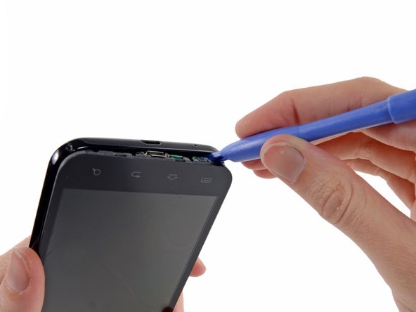

    • Insert a plastic opening tool, or your fingernail, into the opening near the left side of the headphone jack.
    • Pry the opening tool downward to pop the rear case from its clips securing it to the the midframe.

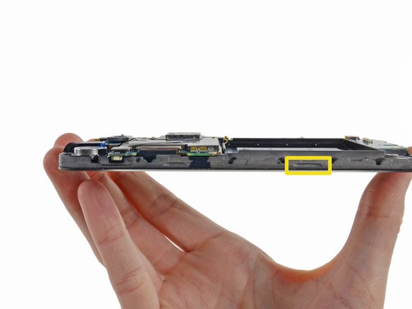

    • Unless you pry at the right insertion points, you might have a difficult time removing the midframe. This shot of the display assembly, with display glass facing down, is meant to help you locate them.
    • The first insertion point is a divot to the left of the micro-USB port.
    • The second insertion point is a divot to the right of the micro-USB port near the corner of the phone.
    • The final insertion point is located about two inches to the right of the volume control toggle, toward the corner of the phone. An additional insertion point is located slightly to the right of the volume button if you need it.

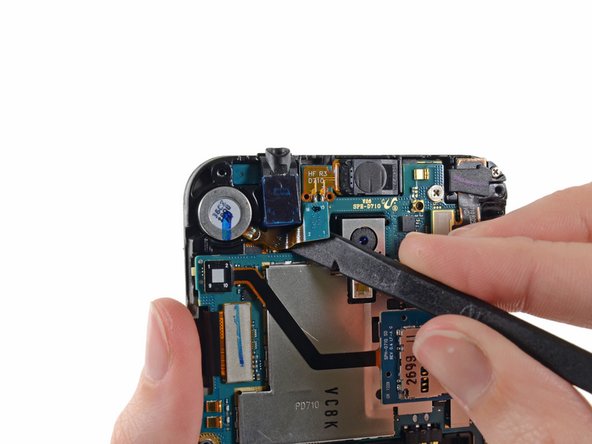

    • Insert the sharp end of a spudger into the gap in the corner of the midframe to free the vibrator from the adhesive.
    • Do not completely remove the vibrator, it is still attached to the headphone jack/vibrator assembly and can only come out with the rest of the unit.
