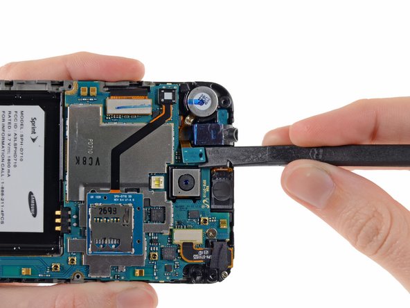

  15. Samsung Epic 4G Touch Front Facing Camera/Earpiece Speaker Assembly Replacement, Motherboard Assembly: crwdns2935265:015crwdnd2935265:01crwdnd2935265:02crwdne2935265:0 Samsung Epic 4G Touch Front Facing Camera/Earpiece Speaker Assembly Replacement, Motherboard Assembly: crwdns2935265:015crwdnd2935265:02crwdnd2935265:02crwdne2935265:0
    • Use the flat end of a spudger to disconnect the front-facing camera cable connector.

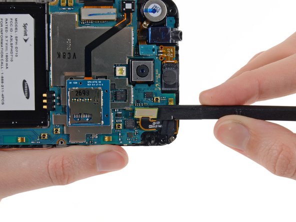

  16. Samsung Epic 4G Touch Front Facing Camera/Earpiece Speaker Assembly Replacement: crwdns2935265:016crwdnd2935265:01crwdnd2935265:01crwdne2935265:0
    • Carefully disconnect the digitizer display cable.

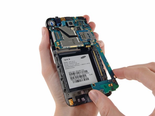

  19. Samsung Epic 4G Touch Front Facing Camera/Earpiece Speaker Assembly Replacement: crwdns2935265:019crwdnd2935265:01crwdnd2935265:03crwdne2935265:0 Samsung Epic 4G Touch Front Facing Camera/Earpiece Speaker Assembly Replacement: crwdns2935265:019crwdnd2935265:02crwdnd2935265:03crwdne2935265:0 Samsung Epic 4G Touch Front Facing Camera/Earpiece Speaker Assembly Replacement: crwdns2935265:019crwdnd2935265:03crwdnd2935265:03crwdne2935265:0
    • Lift the micro-USB end of the motherboard away from the display assembly and pull it down.
    • Be mindful that you don't snag the motherboard on any cables as you remove it.

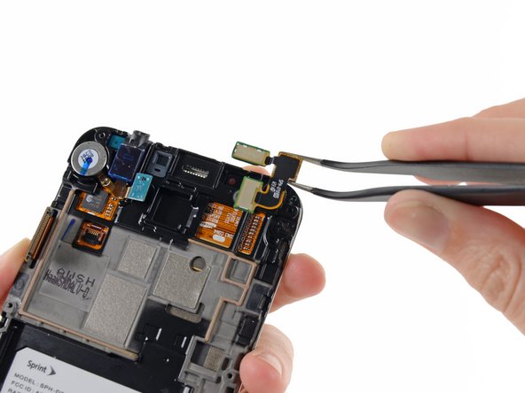

  22. Samsung Epic 4G Touch Front Facing Camera/Earpiece Speaker Assembly Replacement: crwdns2935265:022crwdnd2935265:01crwdnd2935265:02crwdne2935265:0 Samsung Epic 4G Touch Front Facing Camera/Earpiece Speaker Assembly Replacement: crwdns2935265:022crwdnd2935265:02crwdnd2935265:02crwdne2935265:0
    • Using a pair of tweezers, or your fingers, remove the front-facing camera/earpiece speaker assembly.

This Repar is NOT for the earpiece speaker. It is for the camera only. The earpiece speaker for the i9100 is attached to the vibrator and headphone jack cable.
