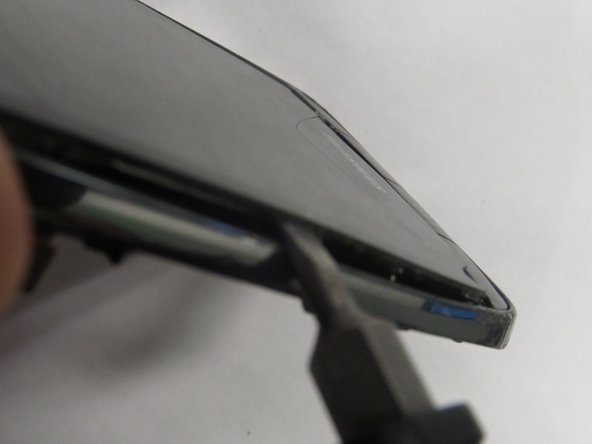

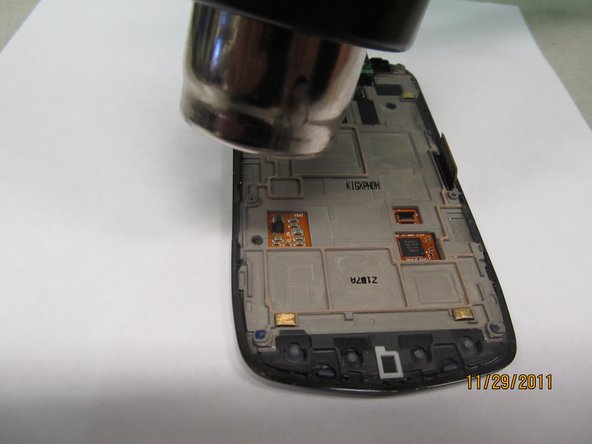

      • Using a hairdryer or heat gun, warm the phone. Doing so will warm the adhesive holding the screen in place, allowing us to continue disassembling the device.
      • Use the pry tool to pry the screen off the casing. You may need to use force to overcome the adhesive.
      • Work carefully to prevent damage to the phone.
