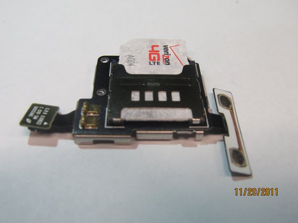

    1. Samsung Droid Charge SIM Card Port Replacement, SIM Card: crwdns2935265:04crwdnd2935265:01crwdnd2935265:01crwdne2935265:0
      • Slide the SIM card out of its casing by pushing on it and sliding it upward.
    1. Samsung Droid Charge SIM Card Port Replacement, SIM Card Port: crwdns2935265:05crwdnd2935265:01crwdnd2935265:01crwdne2935265:0
      • Carefully remove the back cover.
      • Remove the two 5mm screws with a small Phillips head screwdriver.
    2. Samsung Droid Charge SIM Card Port Replacement: crwdns2935265:06crwdnd2935265:01crwdnd2935265:01crwdne2935265:0
      • Removal of the back half of the casing.
      • Using a thin plastic flat head screw driver, or similar item. On the side of the phone insert the thin edge into the visible split between the 2 halves of the phone.
      • Use a prying motion to lift the casing up. This will separate the phone casing.
      • Repeat this motion all around the screen edge until the casing pops off.
    3. Samsung Droid Charge SIM Card Port Replacement: crwdns2935265:07crwdnd2935265:01crwdnd2935265:01crwdne2935265:0
      • Release the volume button flex cable on the right.
      • Release the pop connector on the motherboard located to the left of the SIM card port.
    4. Samsung Droid Charge SIM Card Port Replacement: crwdns2935265:08crwdnd2935265:01crwdnd2935265:02crwdne2935265:0 Samsung Droid Charge SIM Card Port Replacement: crwdns2935265:08crwdnd2935265:02crwdnd2935265:02crwdne2935265:0
      • Your SIM card port is now unattached.
      • Remove SIM card port from motherboard.
