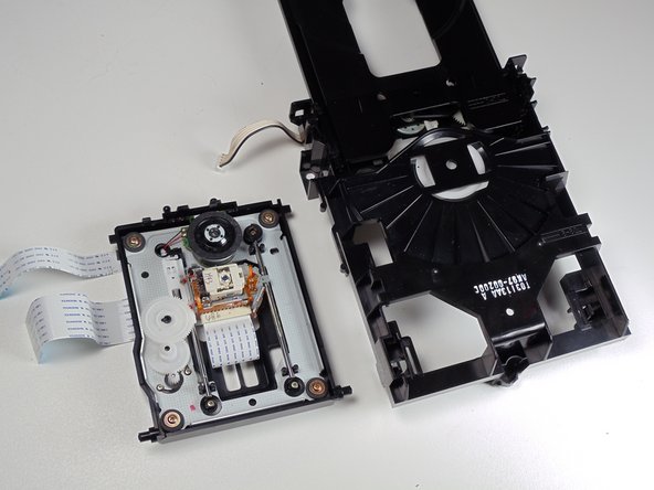

    • Gently lift the DVD tray off of the motherboard.
  11. Samsung DVD-P230 Tray Motor Replacement, Tray Motor: crwdns2935265:011crwdnd2935265:01crwdnd2935265:02crwdne2935265:0 Samsung DVD-P230 Tray Motor Replacement, Tray Motor: crwdns2935265:011crwdnd2935265:02crwdnd2935265:02crwdne2935265:0

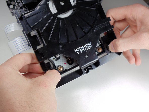

  12. Samsung DVD-P230 Tray Motor Replacement: crwdns2935265:012crwdnd2935265:01crwdnd2935265:03crwdne2935265:0 Samsung DVD-P230 Tray Motor Replacement: crwdns2935265:012crwdnd2935265:02crwdnd2935265:03crwdne2935265:0 Samsung DVD-P230 Tray Motor Replacement: crwdns2935265:012crwdnd2935265:03crwdnd2935265:03crwdne2935265:0
    • Use your fingers to pull the shown tabs towards the sides of the tray, releasing the internal tray that contains the laser.

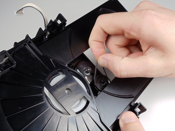

    • In order to remove the tray motor you must detach the small rubber band that runs between the two shown wheels.
    • If the rubber band is improperly fitted onto one of the wheels or broken this is probably the cause of the tray not opening or closing.

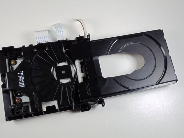

  14. Samsung DVD-P230 Tray Motor Replacement: crwdns2935265:014crwdnd2935265:01crwdnd2935265:02crwdne2935265:0 Samsung DVD-P230 Tray Motor Replacement: crwdns2935265:014crwdnd2935265:02crwdnd2935265:02crwdne2935265:0

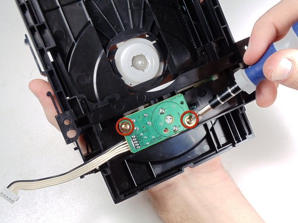

    • Flip over the tray.
    • Unscrew the two screws that attach the motor to the tray.
    • Once completed the motor can be easily removed and replaced.
