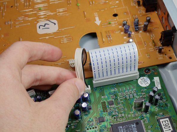

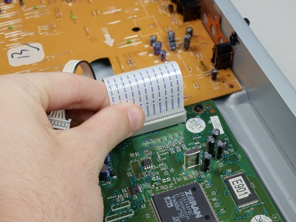

  9. Samsung DVD-P230 LCD Screen Replacement: crwdns2935265:09crwdnd2935265:01crwdnd2935265:02crwdne2935265:0 Samsung DVD-P230 LCD Screen Replacement: crwdns2935265:09crwdnd2935265:02crwdnd2935265:02crwdne2935265:0
    • Remove the power cord and first two ribbons by pulling them directly out of their sockets.

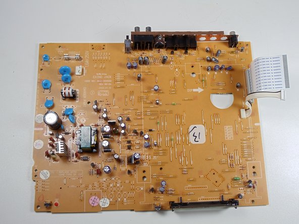

  11. Samsung DVD-P230 LCD Screen Replacement, Motherboard: crwdns2935265:011crwdnd2935265:01crwdnd2935265:02crwdne2935265:0 Samsung DVD-P230 LCD Screen Replacement, Motherboard: crwdns2935265:011crwdnd2935265:02crwdnd2935265:02crwdne2935265:0

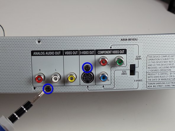

    • Unscrew the 2 screws on the motherboard
    • Unscrew the 2 screws on the back

    • Disconnect the wires and ribbon by pulling them out of their respective connections
  13. Samsung DVD-P230 LCD Screen Replacement: crwdns2935265:013crwdnd2935265:01crwdnd2935265:02crwdne2935265:0 Samsung DVD-P230 LCD Screen Replacement: crwdns2935265:013crwdnd2935265:02crwdnd2935265:02crwdne2935265:0
    • Lift board up and out of the lower case
