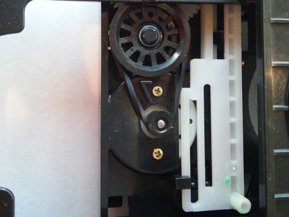

  10. Samsung DVD-HD850 Player Rubber Band Replacement, Locate the White Spindle: crwdns2935265:010crwdnd2935265:01crwdnd2935265:01crwdne2935265:0
    • Locate the small white spindle on the face of the tray (the face is where the DVD name is edged on the front) and turn the spindle counterclockwise (with the screw driver listed under "tools" or something similar) until the tray begins to open

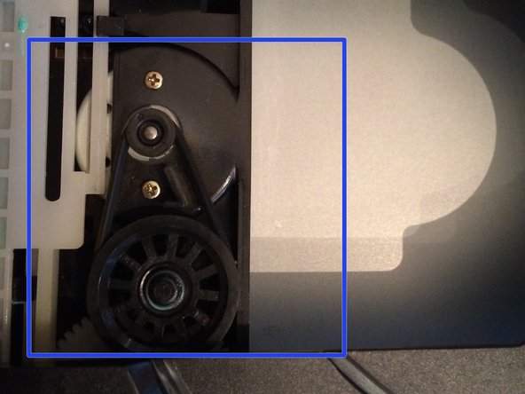

  11. Samsung DVD-HD850 Player Rubber Band Replacement, Opening The Disk Tray: crwdns2935265:011crwdnd2935265:01crwdnd2935265:02crwdne2935265:0 Samsung DVD-HD850 Player Rubber Band Replacement, Opening The Disk Tray: crwdns2935265:011crwdnd2935265:02crwdnd2935265:02crwdne2935265:0
    • Once the tray is opened, locate the rubber band, as noted by the blue box, and remove and replace it by pulling it out of the mechanism
  12. Samsung DVD-HD850 Player Rubber Band Replacement, Rubber Band Replacement: crwdns2935265:012crwdnd2935265:01crwdnd2935265:02crwdne2935265:0 Samsung DVD-HD850 Player Rubber Band Replacement, Rubber Band Replacement: crwdns2935265:012crwdnd2935265:02crwdnd2935265:02crwdne2935265:0
    • Once removed, replace the band with one you have bought, or have on-hand and and insert it into its rightful place
