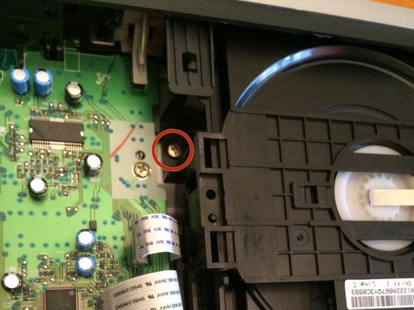

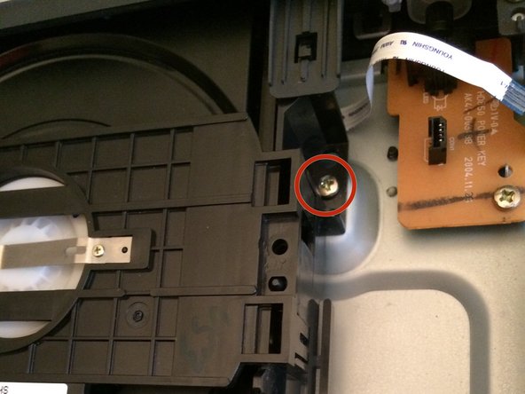

  6. Samsung DVD-HD850 Player Power Button Replacement, Removing The Screws: crwdns2935265:06crwdnd2935265:01crwdnd2935265:03crwdne2935265:0 Samsung DVD-HD850 Player Power Button Replacement, Removing The Screws: crwdns2935265:06crwdnd2935265:02crwdnd2935265:03crwdne2935265:0 Samsung DVD-HD850 Player Power Button Replacement, Removing The Screws: crwdns2935265:06crwdnd2935265:03crwdnd2935265:03crwdne2935265:0
    • As noted by the red circles, locate and remove the screws one at a time
