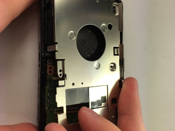

    1. Samsung DV300F Front LCD Screen Replacement, Front LCD Screen: crwdns2935265:07crwdnd2935265:01crwdnd2935265:02crwdne2935265:0 Samsung DV300F Front LCD Screen Replacement, Front LCD Screen: crwdns2935265:07crwdnd2935265:02crwdnd2935265:02crwdne2935265:0
      • Unscrew the 3 silver 4.5 mm screws from the circuit board using a Phillips #0 screwdriver.
      • Remove the circuit board cover.
    2. Samsung DV300F Front LCD Screen Replacement: crwdns2935265:08crwdnd2935265:01crwdnd2935265:03crwdne2935265:0 Samsung DV300F Front LCD Screen Replacement: crwdns2935265:08crwdnd2935265:02crwdnd2935265:03crwdne2935265:0 Samsung DV300F Front LCD Screen Replacement: crwdns2935265:08crwdnd2935265:03crwdnd2935265:03crwdne2935265:0
      • Flip the black tab where the front LCD screen connects to the circuit board.
      • Pull the tape connection to disconnect the front LCD screen from the circuit board.
      • You can do this easily with your fingers.
      • Remove the front LCD screen from the front of the camera.
