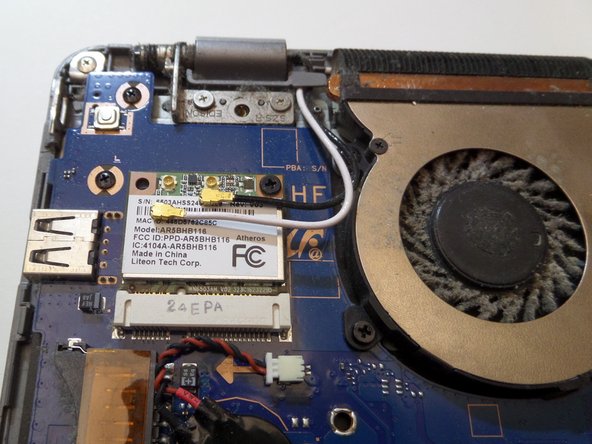

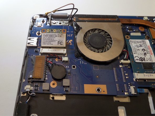

  7. Samsung Chromebook XE550C22 Wifi Card Replacement, Wifi Card: crwdns2935265:07crwdnd2935265:01crwdnd2935265:01crwdne2935265:0
    • Locate the wifi card on the top left of the Chromebook.

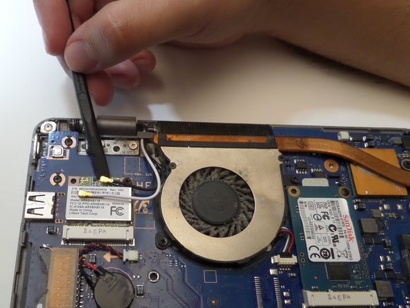

  8. Samsung Chromebook XE550C22 Wifi Card Replacement: crwdns2935265:08crwdnd2935265:01crwdnd2935265:03crwdne2935265:0 Samsung Chromebook XE550C22 Wifi Card Replacement: crwdns2935265:08crwdnd2935265:02crwdnd2935265:03crwdne2935265:0 Samsung Chromebook XE550C22 Wifi Card Replacement: crwdns2935265:08crwdnd2935265:03crwdnd2935265:03crwdne2935265:0
    • Use only plastic tools for this step.
    • Use the spudger to detach the black and white cords from the wifi card.

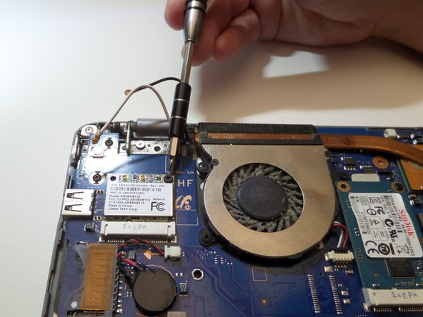

  9. Samsung Chromebook XE550C22 Wifi Card Replacement: crwdns2935265:09crwdnd2935265:01crwdnd2935265:03crwdne2935265:0 Samsung Chromebook XE550C22 Wifi Card Replacement: crwdns2935265:09crwdnd2935265:02crwdnd2935265:03crwdne2935265:0 Samsung Chromebook XE550C22 Wifi Card Replacement: crwdns2935265:09crwdnd2935265:03crwdnd2935265:03crwdne2935265:0
    • Remove the 6mm screw from the top right corner of the card using the J0 screwdriver.
    • The wifi card will "pop-up".

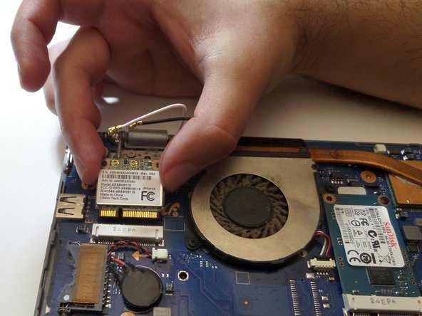

  10. Samsung Chromebook XE550C22 Wifi Card Replacement: crwdns2935265:010crwdnd2935265:01crwdnd2935265:02crwdne2935265:0 Samsung Chromebook XE550C22 Wifi Card Replacement: crwdns2935265:010crwdnd2935265:02crwdnd2935265:02crwdne2935265:0
    • Using your hands, gently remove the card up and away from the Chromebook.
