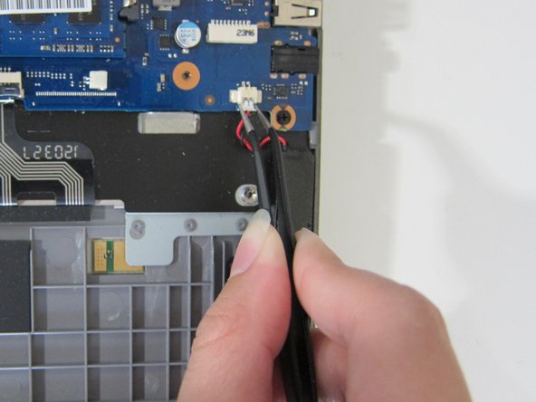

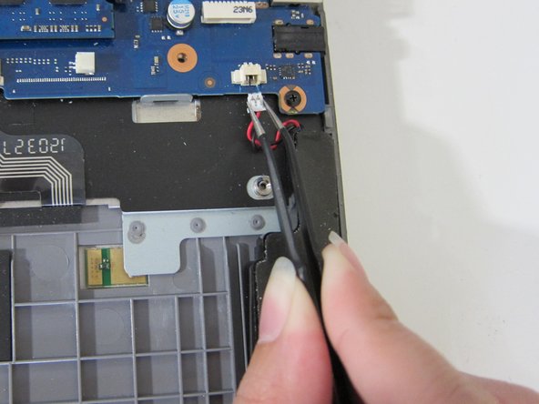

  8. Samsung Chromebook XE550C22 Speakers Replacement: crwdns2935265:08crwdnd2935265:01crwdnd2935265:03crwdne2935265:0 Samsung Chromebook XE550C22 Speakers Replacement: crwdns2935265:08crwdnd2935265:02crwdnd2935265:03crwdne2935265:0 Samsung Chromebook XE550C22 Speakers Replacement: crwdns2935265:08crwdnd2935265:03crwdnd2935265:03crwdne2935265:0
    • Using the fine tipped tweezers, detach the white power clips from the motherboard.
    • This may require some force, but be careful not to damage the cables.

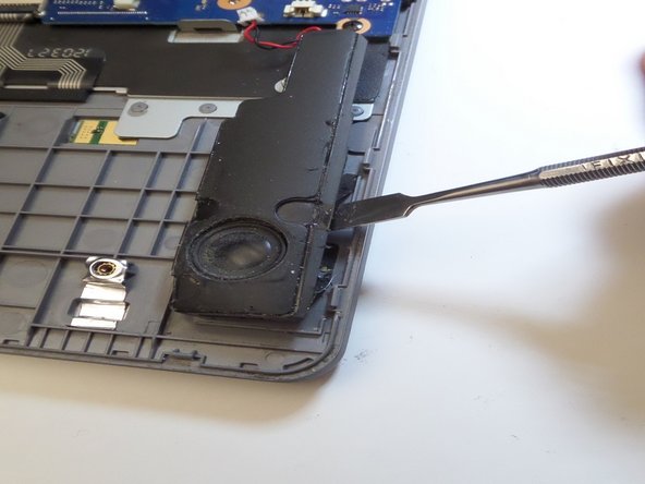

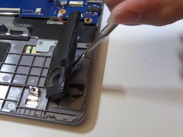

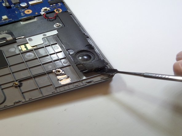

  9. Samsung Chromebook XE550C22 Speakers Replacement: crwdns2935265:09crwdnd2935265:01crwdnd2935265:03crwdne2935265:0 Samsung Chromebook XE550C22 Speakers Replacement: crwdns2935265:09crwdnd2935265:02crwdnd2935265:03crwdne2935265:0 Samsung Chromebook XE550C22 Speakers Replacement: crwdns2935265:09crwdnd2935265:03crwdnd2935265:03crwdne2935265:0
    • Insert the prying tool between the speaker and the Chromebook.
    • Slide the prying tool under the full length of the speaker, severing the glue underneath.
    • This may take some force.
  10. Samsung Chromebook XE550C22 Speakers Replacement: crwdns2935265:010crwdnd2935265:01crwdnd2935265:02crwdne2935265:0 Samsung Chromebook XE550C22 Speakers Replacement: crwdns2935265:010crwdnd2935265:02crwdnd2935265:02crwdne2935265:0
    • Remove the speaker by lifting it up and away from the laptop.
