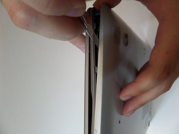

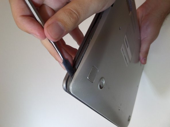

    • Starting at the center front of the laptop, insert the metal spudger between the keyboard panel and the bottom panel, separating the bottom panel from the laptop.
    • Continue prying around the sides to release more brackets.
  4. Samsung Chromebook XE550C22 RAM Replacement: crwdns2935265:04crwdnd2935265:01crwdnd2935265:02crwdne2935265:0 Samsung Chromebook XE550C22 RAM Replacement: crwdns2935265:04crwdnd2935265:02crwdnd2935265:02crwdne2935265:0
    • After deconnecting all the brackets, pull the back panel away from the laptop.
    • Note: The back panel has some flex to it, don't be afraid to use some force.

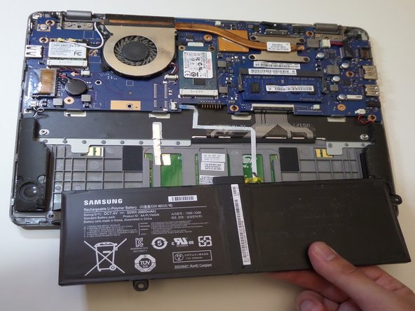

    • Remove the four 3mm screws holding the battery with the J0 screwdriver.
  6. Samsung Chromebook XE550C22 RAM Replacement: crwdns2935265:06crwdnd2935265:01crwdnd2935265:02crwdne2935265:0 Samsung Chromebook XE550C22 RAM Replacement: crwdns2935265:06crwdnd2935265:02crwdnd2935265:02crwdne2935265:0
    • Lift the battery up at an angle to disconnect the battery from the motherboard, then pull it away from the laptop.
    • Do not lift the battery straight up. This will damage the battery's connectors.

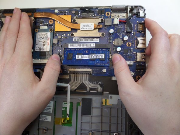

  7. Samsung Chromebook XE550C22 RAM Replacement, RAM: crwdns2935265:07crwdnd2935265:01crwdnd2935265:01crwdne2935265:0
    • Locate the RAM on the middle right side of the Chromebook.

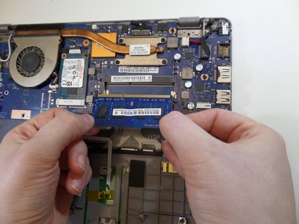

  8. Samsung Chromebook XE550C22 RAM Replacement: crwdns2935265:08crwdnd2935265:01crwdnd2935265:02crwdne2935265:0 Samsung Chromebook XE550C22 RAM Replacement: crwdns2935265:08crwdnd2935265:02crwdnd2935265:02crwdne2935265:0
    • Using your fingers, separate the silver clips that are holding the RAM in place on each side.
    • The RAM will "pop-up" on its own after separating clips.
  9. Samsung Chromebook XE550C22 RAM Replacement: crwdns2935265:09crwdnd2935265:01crwdnd2935265:02crwdne2935265:0 Samsung Chromebook XE550C22 RAM Replacement: crwdns2935265:09crwdnd2935265:02crwdnd2935265:02crwdne2935265:0
    • Pull the RAM away from the Chromebook.
