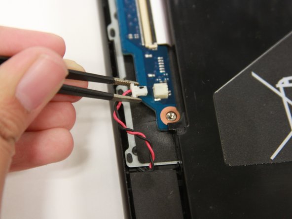

    • Use a blunt precision tweezer to remove the speaker cord from the R.A.M.

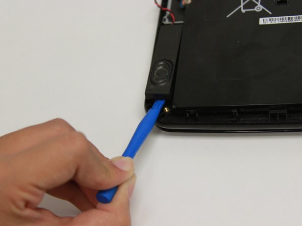

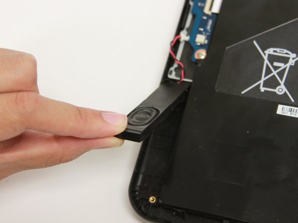

    • Use the prying tool to find the divot then slowly add pressure until the speaker pops out.
    • Gently lift and remove the speaker from the Chromebook.
