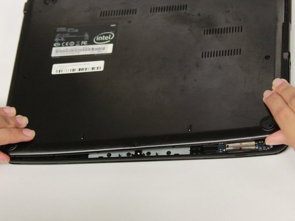

    • Place the opening tool in the divot between the spine of the Chromebook and the back cover.
    • Slowly glide and push down the end of the opening tool along all sides of the Chromebook to detach the brackets. You will hear the brackets detach.
  3. Samsung Chromebook XE500C21-A03US SD Card Reader Replacement: crwdns2935265:03crwdnd2935265:01crwdnd2935265:02crwdne2935265:0 Samsung Chromebook XE500C21-A03US SD Card Reader Replacement: crwdns2935265:03crwdnd2935265:02crwdnd2935265:02crwdne2935265:0
    • Using the opening tool, pry off the back cover of the Chromebook
    • Be gentle while prying to avoid breaking the back cover.

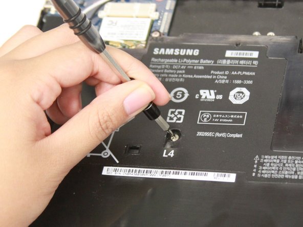

  4. Samsung Chromebook XE500C21-A03US SD Card Reader Replacement, Battery: crwdns2935265:04crwdnd2935265:01crwdnd2935265:02crwdne2935265:0 Samsung Chromebook XE500C21-A03US SD Card Reader Replacement, Battery: crwdns2935265:04crwdnd2935265:02crwdnd2935265:02crwdne2935265:0
    • Remove the four 3 mm screws using a Phillips #000 screwdriver.

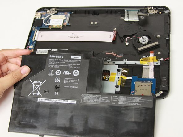

  5. Samsung Chromebook XE500C21-A03US SD Card Reader Replacement: crwdns2935265:05crwdnd2935265:01crwdnd2935265:02crwdne2935265:0 Samsung Chromebook XE500C21-A03US SD Card Reader Replacement: crwdns2935265:05crwdnd2935265:02crwdnd2935265:02crwdne2935265:0
    • Carefully lift the top of the battery then pull it away from you to remove it.
    • Some batteries may be attached via a battery connector. Disconnect the battery connector by simply pulling straight up at its base.

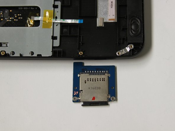

  6. Samsung Chromebook XE500C21-A03US SD Card Reader Replacement, SD Card Reader: crwdns2935265:06crwdnd2935265:01crwdnd2935265:02crwdne2935265:0 Samsung Chromebook XE500C21-A03US SD Card Reader Replacement, SD Card Reader: crwdns2935265:06crwdnd2935265:02crwdnd2935265:02crwdne2935265:0
    • Remove both 3 mm screws using a Phillips #000 screwdriver.
  7. Samsung Chromebook XE500C21-A03US SD Card Reader Replacement: crwdns2935265:07crwdnd2935265:01crwdnd2935265:03crwdne2935265:0 Samsung Chromebook XE500C21-A03US SD Card Reader Replacement: crwdns2935265:07crwdnd2935265:02crwdnd2935265:03crwdne2935265:0 Samsung Chromebook XE500C21-A03US SD Card Reader Replacement: crwdns2935265:07crwdnd2935265:03crwdnd2935265:03crwdne2935265:0

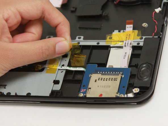

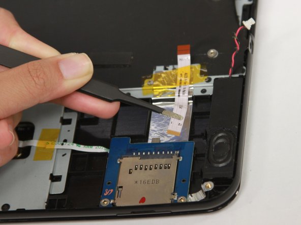

    • Remove the yellow tape on the left ribbon cable with a spudger.
    • Use a blunt precision tweezer to remove both ribbon cables attached to the SD card reader.

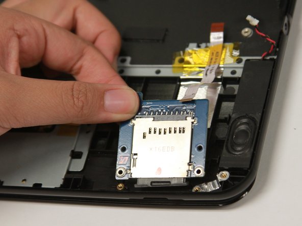

  8. Samsung Chromebook XE500C21-A03US SD Card Reader Replacement: crwdns2935265:08crwdnd2935265:01crwdnd2935265:03crwdne2935265:0 Samsung Chromebook XE500C21-A03US SD Card Reader Replacement: crwdns2935265:08crwdnd2935265:02crwdnd2935265:03crwdne2935265:0 Samsung Chromebook XE500C21-A03US SD Card Reader Replacement: crwdns2935265:08crwdnd2935265:03crwdnd2935265:03crwdne2935265:0
    • Gently lift the top portion of the SD card reader and pull it away from you to remove it.
    • To reassemble, first insert the bottom of the SD card reader then carefully push downward.
